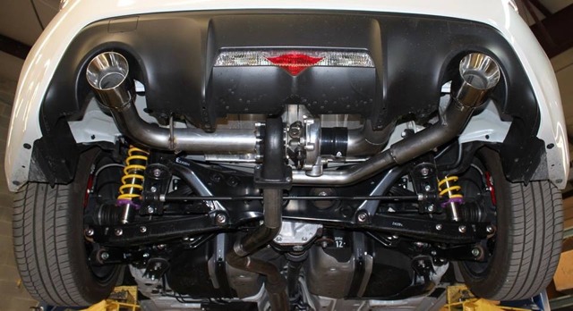

STS single... and twin turbo
http://ststurbo.com/brz/
from fb:

What the hell is that?

A Remote mount turbo setup.
+ Doesn't crowd engine bay.
+ A bit less heat build up in the bay.
+ Weight in the back for better balance.
+ Less passenger noise.
+ Usually quicker to install.
+ Usually cheaper w/no need to turbo specific custom exhaust.
+ Usually cools down a lot faster and may not need a turbo timer.
- Move volume equally slightly slower throttle response (& more lag.)
- Longer the pipe usually means lower boost.
- Speed bump/pothole nightmare on stock/lowered cars.
- Easily prone to theft in my area.
never owned a remote setup but a friend while I was at school had a set up on his 05 GTO.

Just my .02$ from what ive heard about these
The rear mounts dont need intercoolers, and therefor ive been told the boost and lag are very comparable to a bay mounted turbo w a fmic

You forgot another couple minuses in that you have to run oil lines all the way to the rear of the car and I am assuming it uses an inline pump in the return line to get the oil back to the pan.

I remember wanting to use this kit on my 370Z until someone posted an article explaining how this set up creates some nasty back pressure.
I can't remember the details.this kit is pretty cheap and it's like having a performance exhaust already in the set up.
if it were so good it would make you wonder why more people don't use it.
