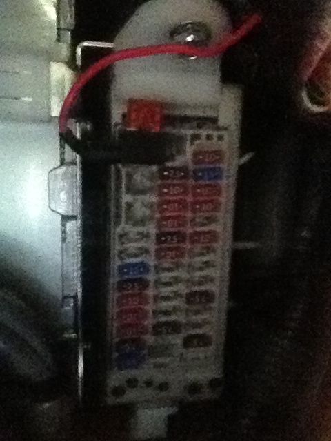

I have blue leds, under the steering and glove box then the other two under the seats! I tapped into the 12v source in the glove box (easy + and - ). The lights come on from acc. and stay on until you turn them off (with a control box). I'll post a DIY soon. Here's a quick photo for now;
check out my on-going build here: My blue 86
