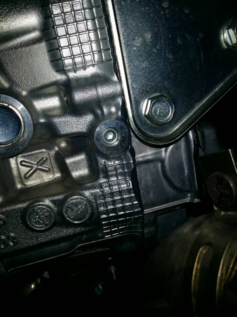

I'm at 3500km now and no signs of leaks at all
I'm a 2013 manufactured frs
I believe most 2012 manufactured frs leak at that area

@Young_makaveli: You did that or that's OEM?
Sent from my SM-N900W8 using Tapatalk
Mine is July 2013 build. To make sure it isn't leaking, run a piece of paper towel along the bottom of the cam plate. I did this and sure enough there was oil residue.
That's OEM
Yeah I already did that and nothing
