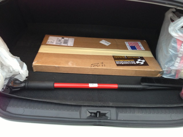

Well, i put the second skin in my trunk, but i cant tell the difference! Waste of money
...but seriously, im hoping to install tonight or tomorrow

Gave me a heart attack until I viewed the picture. I got a free sample from GTMat back in November and a friend with some leftover Peel & Seal, but a slew of health issues arose that prevented me from touching anything on may car since then.
I'm very curious to see how your trunk-only install turns out, as my SRT headerback is also quite droney. I've been debating using the GTMat for addressing plastic rattling in the front doors and dash and Peel & Seal for the trunk since there's no need to worry about adhesive failing when gravity isn't tugging it anywhere.
