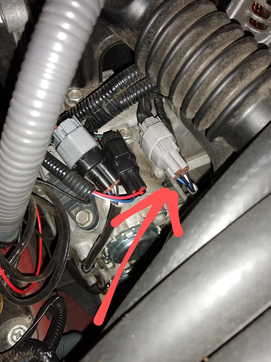

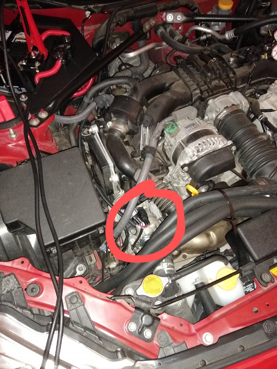

Yes, just the connector on the front, left side of the engine. This should tell the ECU that your upstream O2 sensor is at fault and should default to a base map so that the engine will run (probably in limp mode) but this should also turn your check engine light on and (maybe) allow it to run for a little while.
See these pictures here,
The upstream sensor is the one on the right side that the red arrow is pointing to in the second picture.
