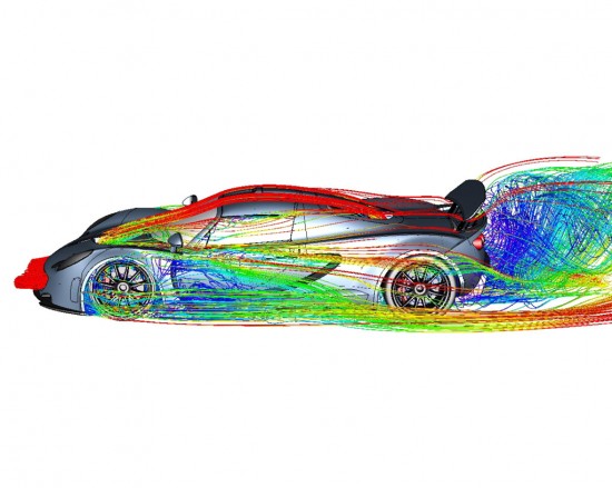

My partner and I have been doing some CFD testing on the FR-S. Using the model we have, we estimate the CL to be .179, but our model has a smooth underbody. I don't expect the BRZ to have a different coefficient. A little more info is on our blog here: http://hanchagroup.wordpress.com/201...s-cfd/#more-27
What are you using for your model? Is it a computer generated model or a physical model?
Thanks for doing the testing. Your C_d is lower than the manufacturer claim most likely because you essentially have a sealed front grill (radiator causes drag), smooth bottom, and non rotating wheels.
There's no need to tuft test the car as this is essentially the usual fastback. Lesson number 1 about streamlining is it's all about the rear, not the nose. Pointy nose is (slightly) worse than blunt nose at subsonic speed, just look at a Boeing 747.
The "problems" with the rear end are as you can see the 2 giant blue vortices (this is because while the rear window is sloping downward at a nice gentle rate, the car's body isn't getting narrower laterally, so the air that gets pushed to the side of the car is still travelling fast while the air going over the top of the car is slowing down), and the green zone over the trunk (separated flow, read the aero streamlining template thread on ecomodder for more info).
The factory spoiler helps with these slightly by essentially raising the effective height of the trunk lid and bringing it closer to where it "should" be for that length of car. Lowering the car has the effect of blocking off more of the tire area "visible" to the flow, and it also affects the "fineness ratio" (in a positive way, as in reducing drag) which I understand to be a sort of height vs. length thing, I don't really understand it but I think the effect lowering has on this is because of the ground.

EarlQ, the world is a better place because of your work. If you'd be willing to distribute your solid model, I (and others) would be glad to improve it and run a heap of simulations. I'm a MechE that primarily works with Pro/E, and so-so with SolidWorks and Inventor. Minimal CFD, but some magnetic and stress FEA work. If it's validation, we can do that... but I imagine the primary benefit will be identifying "hot spots" and testing solutions for both Eco and Track purposes. Alot of smart folks on here with similar interests.
Serial, you mentioned that the classic fastback shape and its implications. Which are your expectations for the FR-S? Boxy sedans will benefit from vortex generators + well placed spoiler (use turbulence to minimize the volume of "dead air" behind the car). Porsche-style cars are pretty eco-friendly out of the box, and tend to benefit from grille blocking and diffuser work. Once the car is "eco" it becomes a great platform for downforce, such as in the Hennessy Venom GT:
