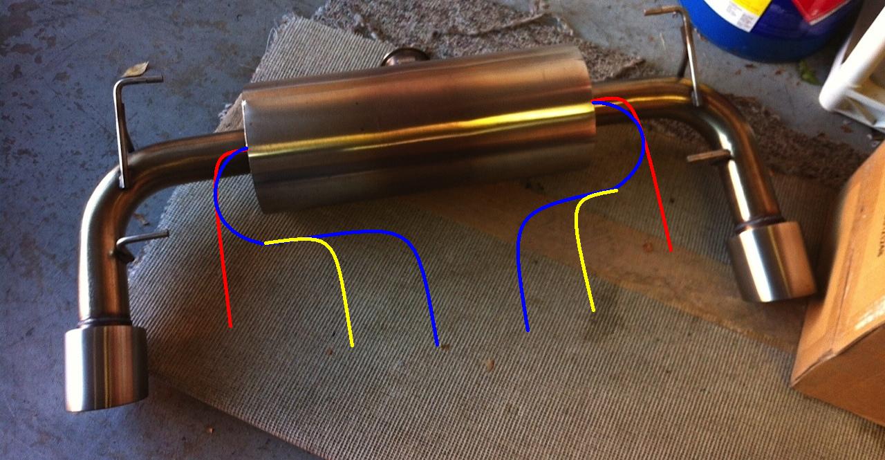

Have you considered using a Perrin exhaust? The design of the muffler/ pipe routing looks like it would work perfect for this. The muffler inlet is in the center and out of the way. Also pretty small and sits more toward the front of the car. The only modifications needed would be to cut off the outlets and move the bends closer to the muffler. May be a little more tweaking than that but it would be an excellent starting point and there is a GB for $770 shipped or something.

Could offer a few different options pretty easily. Just and idea.

Honestly not sure if there's enough room... but could a mufller fit longitudinally?
If you size the muffler properly, a quick bend behind the differential, fit the muffler front-rear tilted upwards, tips installed on the outlets.
The minimum size Mangaflow offers has a case length of 14". Total length with inlets and outlets is 20". I imagine that might fit with some coercion. LINK
With regard to melting things, it's simple enough to cut the mesh and weld a ring into place that leaves sufficient room for the tip to jiggle (3/4" clearance or so, if mounts are fairly solid). Heat shields or a wrap would be nice, but it may not be necessary with how open that design is. We shall see.

I'm relatively certain there's no way to fit an off-the-shelf exhaust to that diffuser without hacking up the diffuser OR the exhaust, so you might as well go custom.

As a few have pointed out, no point in hacking up a brand new exhaust. It would need lots of manipulation. I thought a lot about the exhaust and its design for this.
With the diffuser brackets and the Y pipe in the stock muffler compartment it is not feasible to have a muffler back there. My exhaust man and I decided to put a nice long cylindrical race magnaflow muffler under the middle of the car sort of like the borla set up.
There are some trick race magnaflows that are 6" in body length and 4" or 6" in diameter. Very compact. I initially thought about using these in stock location.
To have the exhaust exit like I want it to the bumper beam will need two holes cut into it. Alternatively I could use the hole in the diffuser which was originally intended for exhaust on the Elise/exige. I just don't like that location because it defeats the point of a diffuser...
