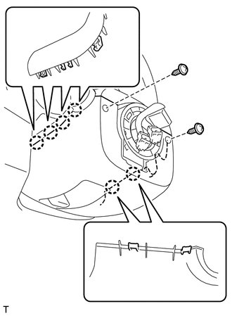

Prep
  1. Put the key in the ignition and turn to acc to unlock steering
  2. Turn the wheel to the left & right and remove the exposed phillips screws on the column (steering wheel doesn't need to be removed)

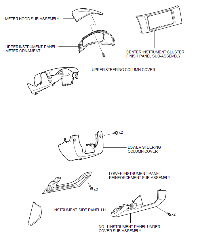

Remove trim pieces
  1. Remove the instrument side panel (pry away from the dash starting from the bottom then moving up the rear-ward side, clips disengage leftwards)

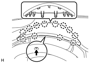

  2. Remove the 2x phillips screws (one at the bottom behind the panel that was just removed, and the other under the dash to the left of the center console)

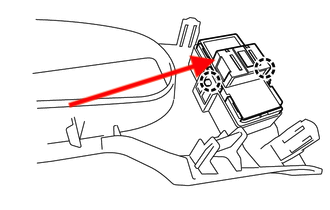

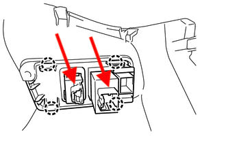

  4. Disconnect the wire connectors for the trunk button & instrument dimmer (push tab in, then pull plug out) (don't remove the button assembly from the trim panel)

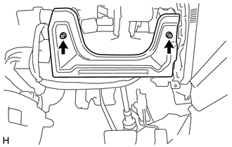

  5. Remove the 2x 10mm bolts holding the lower instrument panel reinforcement in place and remove reinforcement

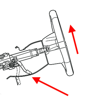

  6. Unlock the steering wheel tilt adjustment so the steering column drops to it's lowest position, and leave it unlocked
  7. Remove the lower steering column cover (push lightly at seams to pop apart) (don't remove the top yet)

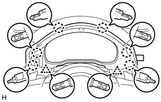

  8. Remove the center instrument cluster finish panel (radio/dash trim piece) by prying it rear-ward (it obscures part of a panel that will be removed)
  9. Remove the 1x phillips screw holding the instrument cluster "meter hood" and remove hood by sliding it rear-ward (a stubby screwdriver or 1/4" phillips bit on a ratchet works best for the screw)

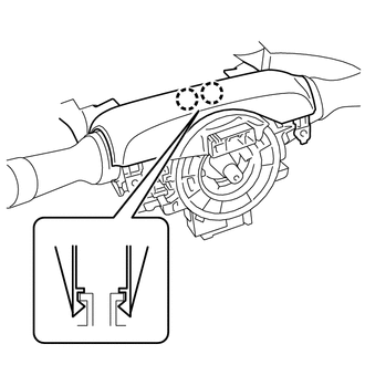

  10. Disengage the upper steering column cover by pulling up, maneuver it up and away from the key collar (it will still be attached to the car via a piece of material)
  11. Remove the upper instrument panel bezel by pulling sides rear-ward, then lifting up the center (it will be attached to the upper steering column cover, fold the steering column cover up into the bezel)

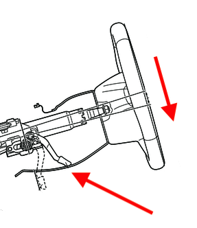

  1. Lift steering column tilt to highest position and re-engage tilt lock

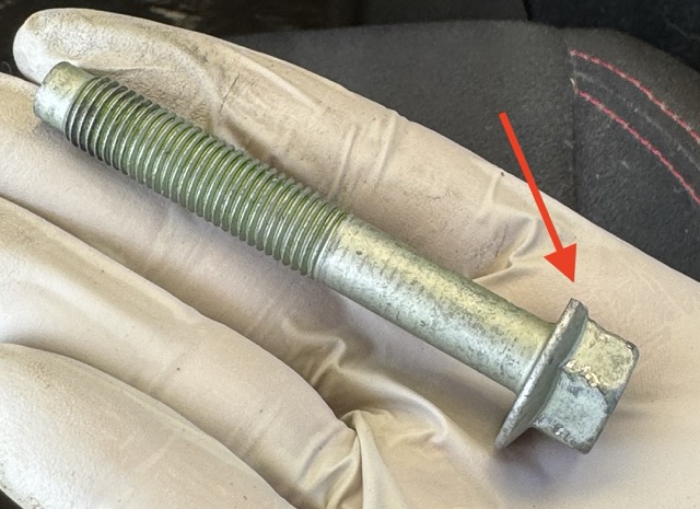

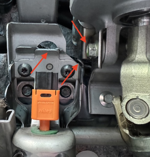

  3. The troublesome flange bolt, here's what we're dealing with... The bolt will get caught on the two metal tabs...
  4. Disconnect (carefully!) the brake pedal sensor wire connector (push tab in while holding body in place, then pull out)
  5. Use an open-ended wrench to unscrew the 14mm flange bolt on steering column under dash and pull it out till it becomes wedged on brake mounting bracket (grab and wiggle the EPS motor sticking up from the steering column to remove pressure from the bolt)
  6. Try fighting with 14mm flange bolt (lifting EPS motor helps), or use dremal in next step (what I ended up doing after a while)
  7. Use a dremal with small grinding bit to grind off a side of the flange bolt (grind while it's still partially in place and wedged with the brake mount) (oddly Toyota considers the bolt disposable and it's meant to be replaced with a new one, I'll be re-using it...)
