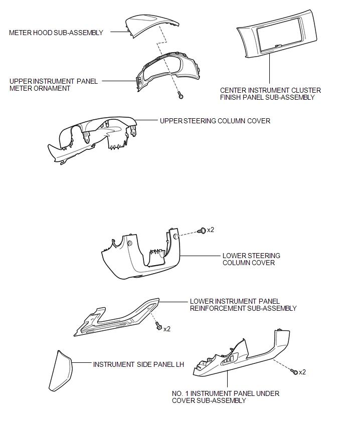

Remove trim pieces

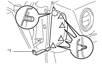

Attachment 224818

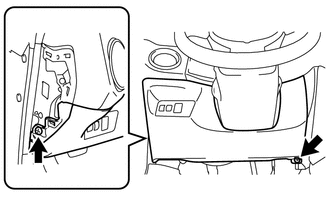

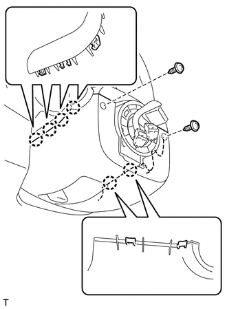

  1. Remove the instrument side panel (pry away from the dash starting from the bottom then moving up the rear-ward side, clips disengage leftwards)
    Attachment 224819
  2. Remove the 2x phillips screws (one at the bottom behind the panel that was just removed, and the other under the dash to the left of the center console)
    Attachment 224820

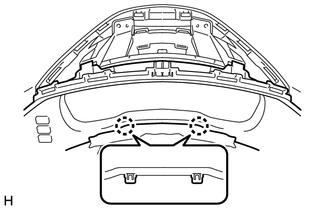

  3. Pull the instrument panel under cover rear-ward to disengage (it will still be connected with some wires)
    Attachment 224821

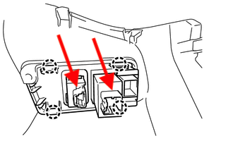

  4. Disconnect the wire connectors for the trunk button & instrument dimmer (push tab in, then pull plug out) (don't remove the button assembly from the trim panel)
    Attachment 224822

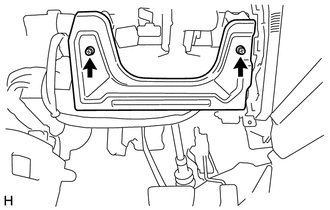

  5. Remove the 2x 10mm bolts holding the lower instrument panel reinforcement in place and remove reinforcement
    Attachment 224823
  6. Unlock the steering wheel tilt adjustment so the steering column drops to it's lowest position, and leave it unlocked
    Attachment 224824

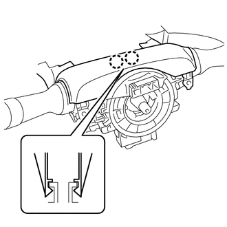

  7. Remove the lower steering column cover (push lightly at seams to pop apart) (don't remove the top yet)
    Attachment 224825
  8. Remove the center instrument cluster finish panel (radio/dash trim piece) by prying it rear-ward (it obscures part of a panel that will be removed)
    Attachment 224826
  9. Remove the 1x phillips screw holding the instrument cluster "meter hood" and remove hood by sliding it rear-ward (a stubby screwdriver or 1/4" phillips bit on a ratchet works best for the screw)
    Attachment 224827
  10. Disengage the upper steering column cover by pulling up, maneuver it up and away from the key collar (it will still be attached to the car via a piece of material)
    Attachment 224828

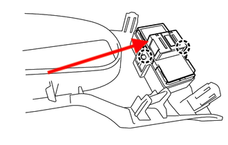

  11. Remove the upper instrument panel bezel by pulling sides rear-ward, then lifting up the center (it will be attached to the upper steering column cover, fold the steering column cover up into the bezel)
    Attachment 224829
    Attachment 224830
  12. Disconnect the wire connector for the instrument display buttons (push tab in, then pull plug out, plug disconnects upwards)
    Attachment 224831
  13. Remove the now detached upper steering column cover / upper steering column cover

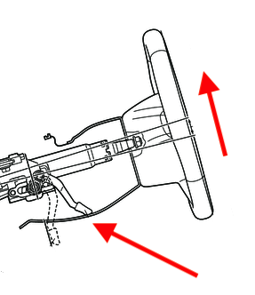

  1. Lift steering column tilt to highest position and re-engage tilt lock
    Attachment 224832

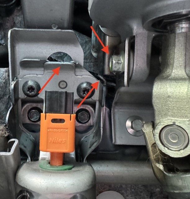

  3. The troublesome flange bolt, here's what we're dealing with... The bolt will get caught on the two metal tabs...
    Attachment 224834
  4. Disconnect (carefully!) the brake pedal sensor wire connector (push tab in while holding body in place, then pull out)

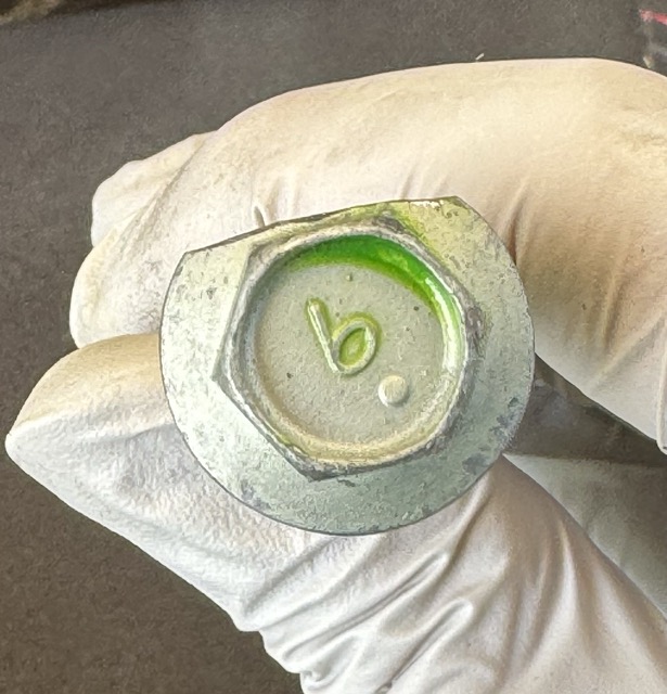

  5. Use an open-ended wrench to unscrew the 14mm flange bolt on steering column under dash and pull it out till it becomes wedged on brake mounting bracket (grab and wiggle the EPS motor sticking up from the steering column to remove pressure from the bolt)
  6. Try fighting with 14mm flange bolt (lifting EPS motor helps), or use dremal in next step (what I ended up doing after a while)
  7. Use a dremal with small grinding bit to grind off a side of the flange bolt (grind while it's still partially in place and wedged with the brake mount) (oddly Toyota considers the bolt disposable and it's meant to be replaced with a new one, I'll be re-using it...)
    Attachment 224835
    Attachment 224836
  8. Rotate the flange bolt to clear the brake mounting bracket and remove the bolt (lifting the EPS motor can help too)

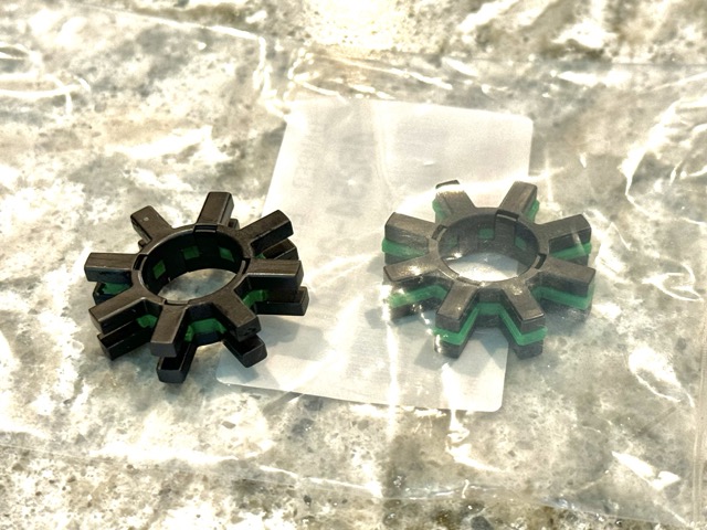

  4. Remove the plastic damper that was between them (Don't loose the little rubber star in the middle!!!)
  5. Clean out the chunks of rubber laying in both sides (column & motor) (check using mirror or phone to make sure you got it all)
Reassembly - steering column
  1. Rotate and hold the steering column so it's facing the right way up (steering wheel will still be on floor supporting weight, just hold the column so it doesn't rotate back around)
  2. Put the new damper in the steering column side, make sure it slips down around the teeth
  3. Put the rubber star in the middle of the damper, it should be laying flat

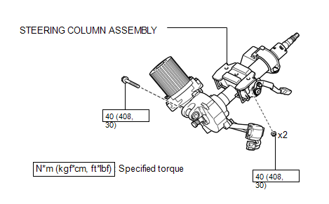

  9. Torque specs
    Attachment 224837
  10. Tighten the 14mm flange bolt - specs say 40 Nm (408 kg-cm, 30 ft-lb) but I didn't bother with a torque wrench due to space issues

  13. Lift the steering column up and finger tighten the 14mm nuts
  14. Tighten the 14mm nuts to spec - 40 Nm (408 kg-cm, 30 ft-lb) (these I did to spec to prevent the column becoming loose in the future while driving)
