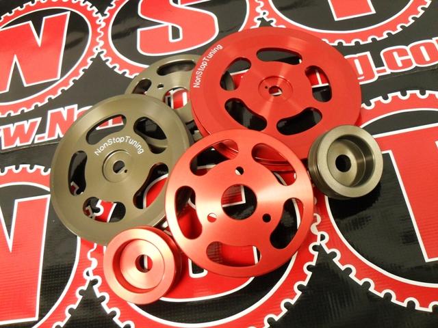

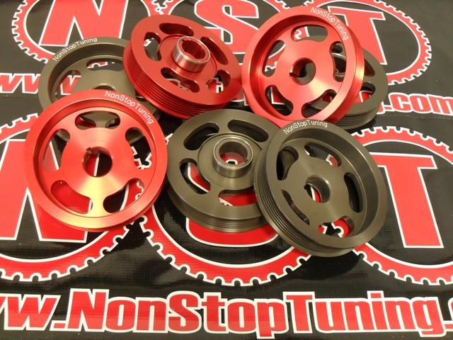

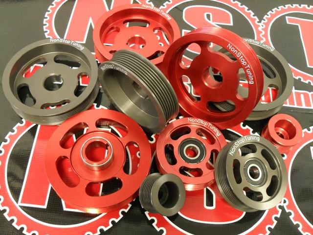

NonStopTuning has offered custom pulleys, in various sizes, since 2005. You send us your pulley, we pull measurements, and build you a custom pulley in any size and/or pattern your project requires.
