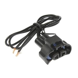

Originally Posted by xrinnenganx View Post
Yea they are the same build size. And that's what I was thinking to do too! So I pretty much take the prism bulb and put it in place of the fog light bulb, and I have to disconnect the fog light bulb by (I'm assuming just twist it off the wiring harness?)
To take the bulb out you just grab it and turn it counterclockwise and pull it out. To disconnect the bulb from the foglight harness you press down on a clip and wiggle it out. The harness should look like this.
The top of that is where the clip clips into, on the harness side, press down on there and it should come out with a little wiggling
Dude thanks so much! I'll be trying this as soon as I can!
