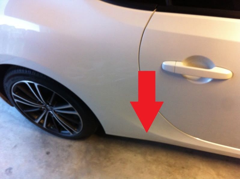

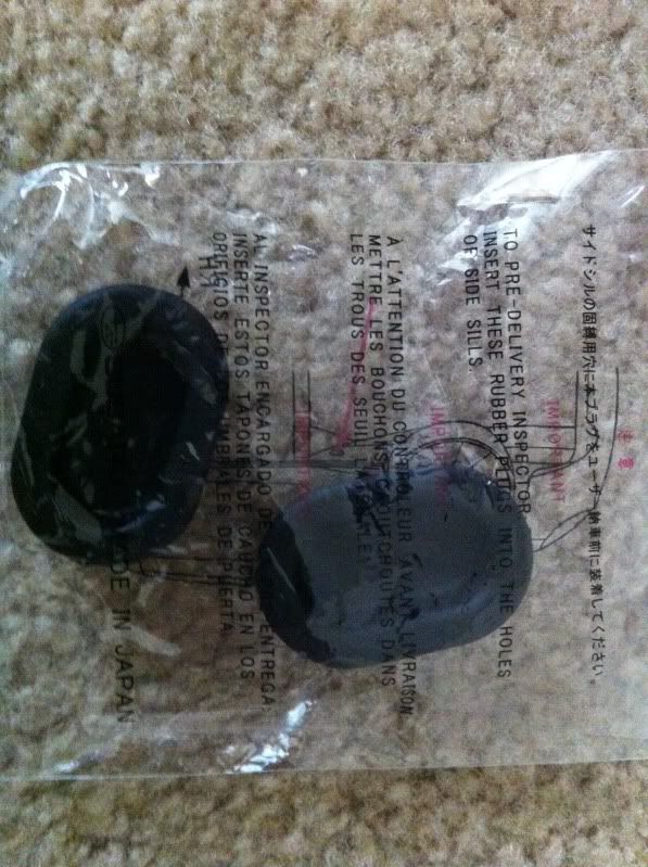

So after I drove my new FR-S home a few days ago, I noticed a package in the glove compartment. It says "To Pre-Delivery Inspector," Insert these rubber plugs into the holes of the side sills. I just thought they were extra pieces not used but curiosity got the best of me so I googled "rubber plug side sill" and found this link (BRZ forum):
http://www.**************.com/9-suba...ill-plugs.html
The dealer didn't install them during the PDI. If you look under your car just in front of the rear wheels (under the door area) you will see where these plugs go (see pic below). The BRZ forum describes what they are used for but you have to register on the site to see the pics. I took these photos myself. In any case, if you do find these plugs in your car still in the package...you now know where they go!
Be careful and wear gloves as there is a lot of grease and lubrication around the hole.
From the BRZ forum: (These plugs are simply a body fill plug. They are part of a standard PDI process to install before delivery. It is always a toss up to where they get installed or not. All they do is plug the frame rail holes. Some of us dont install them because if water gets in the frame rail it wil lhave no where to exit promoting rust and corrosion. Its more of a catch 22. If the plugs are there water shouldnt be able to get in. Its all personal preference to whether or not you want them in. I do know the holes are there for transport purposes for when they are tied town to the boats for shipping and for the transport trucks to deliver them. Thats why the plugs are not installed until they arrive at the dealer. )
