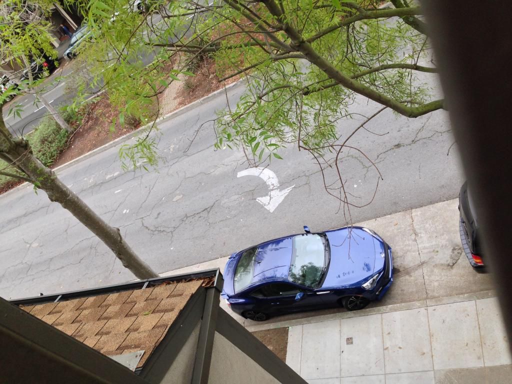

How it sits now:
Picture out of date, but who cares.

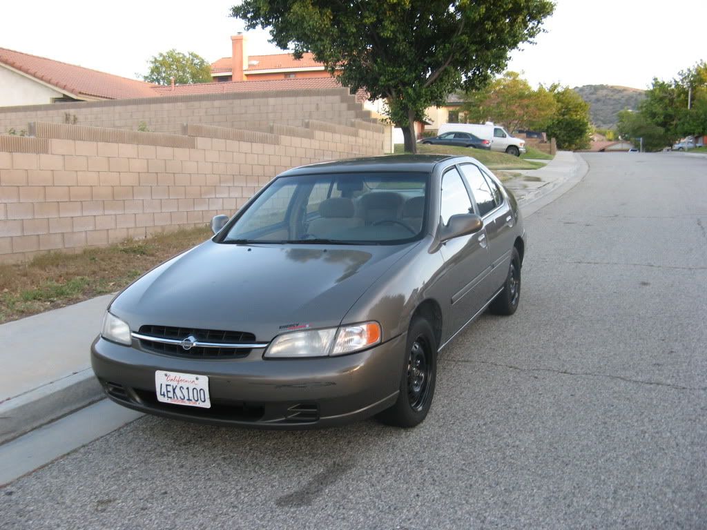

Turns out that Maxima bushings fit the Altima, especially after you machine out the sleeves. Handles real good after that, but eventually you want more.

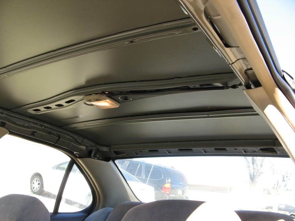

Weight Reduction!

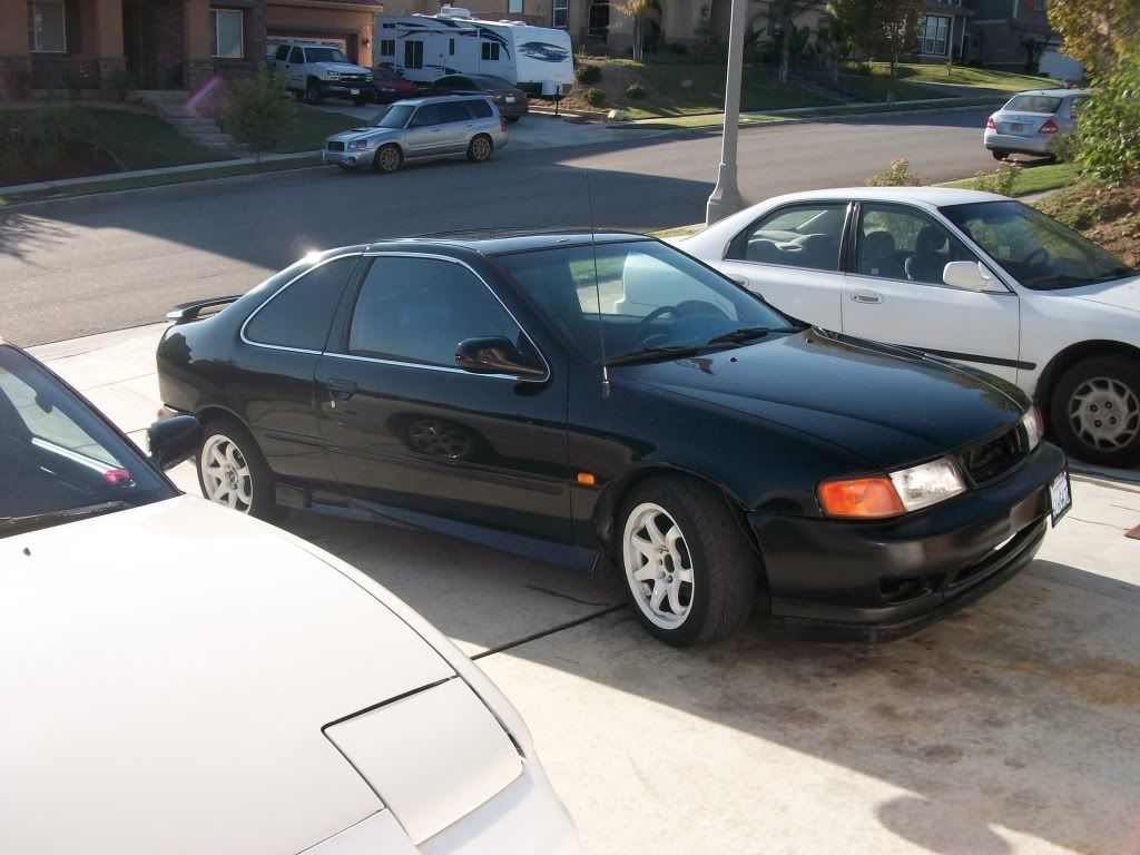

Accord front lip, Autozone foglights, and some goddamn Speedlines (off an Evo 1!)

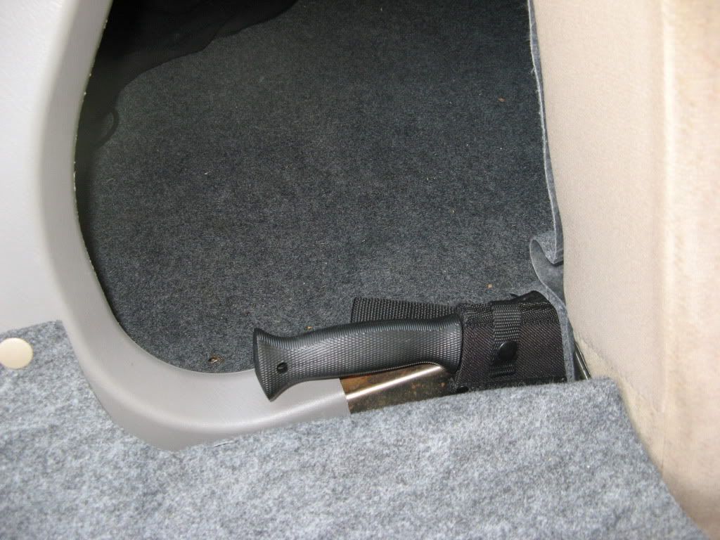

I don't know what your state laws are, but concealing a knife in your car like that seems like a really, really bad idea, especially with how insane the police are these days. That looks like you're asking to get your ass beat.

Nissan guy thing. I have knives on me all the time.
We sometimes threaten each other with them, but I don't think it translates.
Lol that would be bad. Wonder if I'd be able to talk my way outta that...

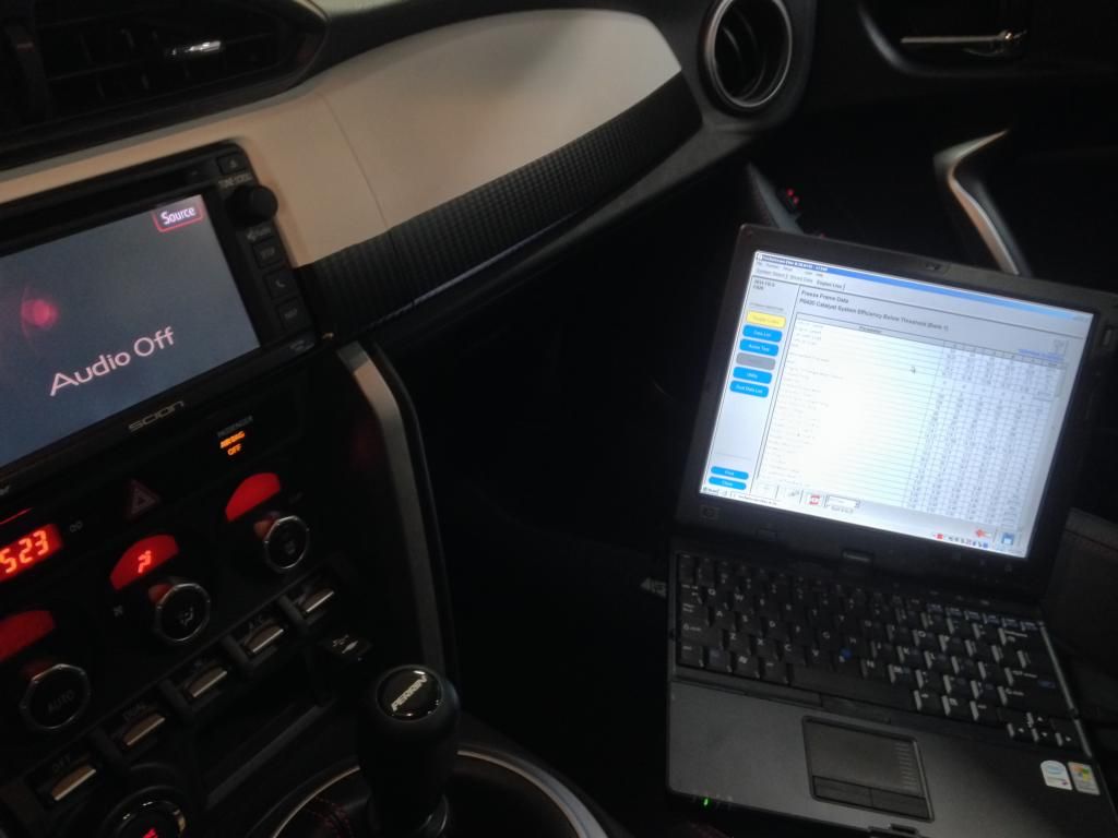

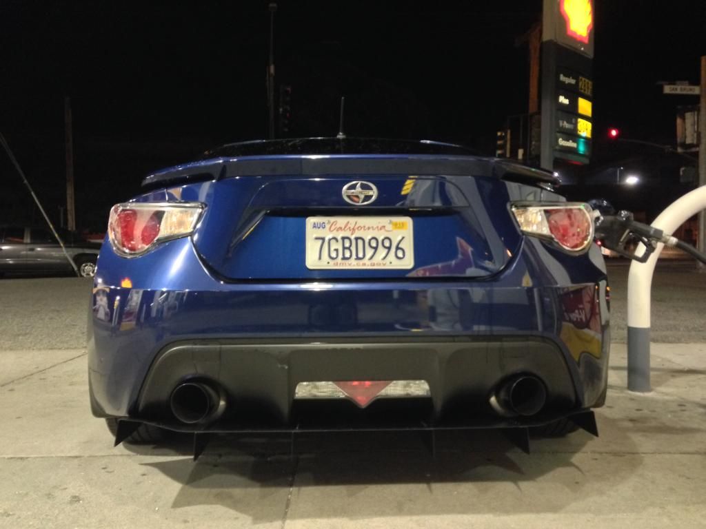

Today I earned my first check engine light! Cruise control kicked off and the cruise indicator light, oddly, turned amber. Still runs decent with like 50mpg cruising at 35mph, I'll look at it soon. 6500 miles...

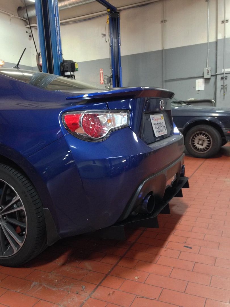

I also got my diffuser on! It's a nice piece, and well-packaged, but it inerferes with EVERYTHING.
I don't mean it scrapes. I mean the exhaust didn't clear, the mudflaps didn't clear, it doesn't even clear the flange on the panel to which it fastens. So you end up with self-tapping screws not fastened all the way, if you install it the way they advise.
I unfastened the inner fastener on my mudflaps, removed the rear inner fender liners and used some bolts with nut and fender washer, and then I had to cinch up my exhaust hangers with a hose clamp. The result is a bulletproof mounting and 1mm clearance between the exhaust and diffuser, with no rattles. Killer. (plus, fender washers look sweet)
I didn't think it would change much, but I really can tell the car is now more stable at high speed. It's not a game-changer, but now there's no anxiety with cornering at 60+ mph. Or, I presume, going straight at 95+ mph (though I rarely do). Of course, the improvement for me would be bigger because my cat-back actually generates upforce compared to standard.
Overall it's a good mod. As one guy at my shop yelled out: Need For Speed Underground!
Although I get embarassed when people ask me how much it cost haha. At least it distracts from my expensive header though

Cruise started working when I cleared the fault, P0420 catalyst efficiency. Literally, danger to manifold.

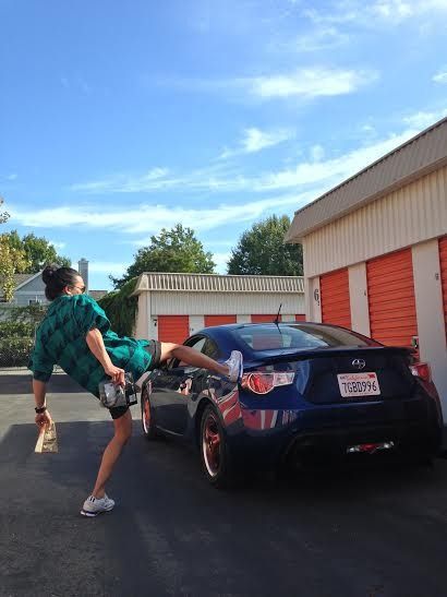

Volks installed! Roughly 60 offeset means I needed some 20mm spacers for my 16x7s. A guy was selling them for $400 locally partially because no one wants 3 spoke wheels, partially because one tire was fatally nailed and he had a 4WD Impreza, partially because no one wants orange wheels, and partially because his rattlecan paint job is a 10-footer at best. Whatever, his loss is my gain. I was literally looking for brightly coloured 3- or 4- spoke wheels from a good brand. I put one on a scale and they are heavy: 17 pounds
Clearly, I make money doing food delivery in my spare time:
NO STEP:
The spokes actually stick out past the wheel lip, which is itself absurdly deep for a 60 offset.
The spacers are universal, the wheels are not. 5x100 lug bolt holes and also some 5x100 speed holes.
