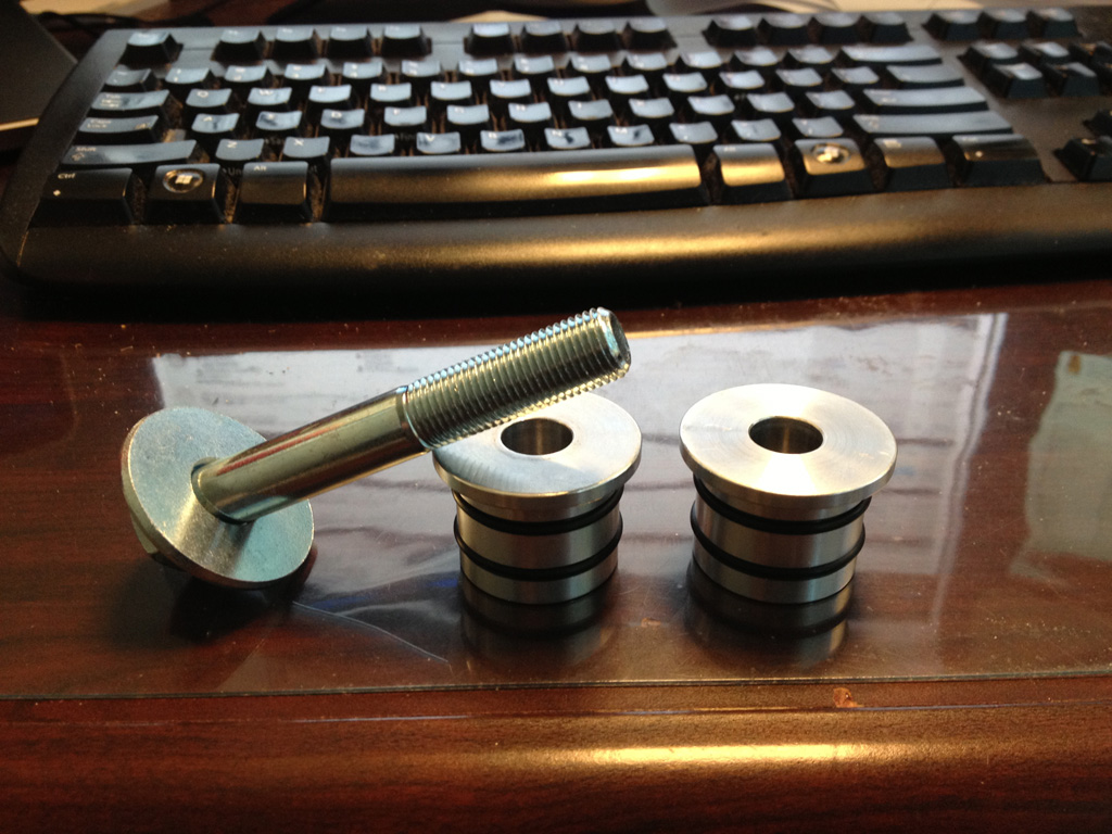

These TiC SR bushings replace the factory Subaru/Toyota SR bushings and are designed to remove play from the rack's mount. The OEM bushings are soft rubber pressed around a metal sleeve and then pressed into the rack. The problem with the OEM bushings is two-fold: 1) They consist of a VERY SOFT rubber which is grooved providing lots of space for the bushing to move around and 2) The bolts holding the bushings to the subframe are smaller (by ~2mm) than the metal sleeve in the middle of the bushing. The reason for the soft rubber, etc is to reduce NVH. TiC instead uses solid bushings made of Aluminum with rubber o-rings around them and bolts that fit in the bushings perfectly without any play. The pros of a design like this is that you feel more through the steering wheel than you would with the OEM bushings and the car responds quicker to steering input. The cons are an increase in NVH (basically feeling more through the steering wheel).
Pics of the box and parts:

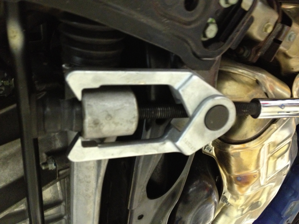

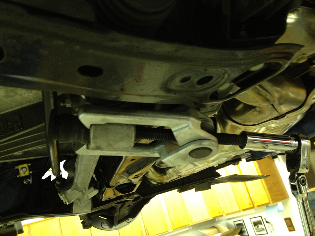

The only things I did differently was that I used a two-jaw puller (swing arm design) as seen below:
