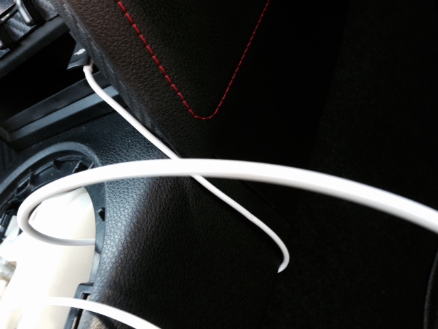

Next, remove the ebreak boot and unscrew off the shifter knob. You will also need to "pop" off the shifter bezel to access the space under it. I pluged in the USB end of the cable into the USB drive, then "snaked" the cable around the side and up untill I could see/reach it.

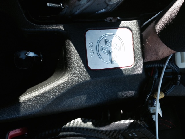

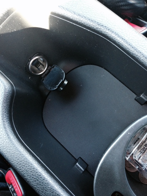

Next, Look into the middle console and you will see the 12V popwer port. You will notice that there is a small rectangle opening on the bottom of it. This is where you will reach inside through the shifter opening and guide the small end of the USB cable into that opening. I have quite big hands but I was still able to do this.
Put everything back...

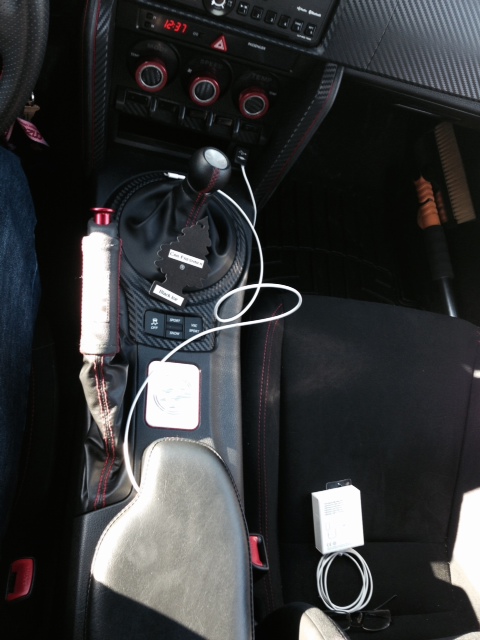

I do use my phone for GPS and I wanted to make sure that if I needed to see the phone, the cable was also long enough to reach the other side of the shifter so it would "stand up" while I drive. This just shows you the reach the cable can go.

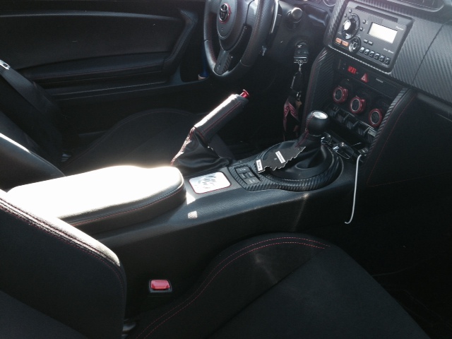

This is the passenger side view. I could make a hole and have the cable be tucked away up much higher, but this is just the way I did it.
