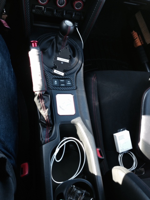

So if you're like many of us with an Iphone 5, you might find it kind of hard to charge it and/or trying to make the inside look "clean" from wires. This is just how I ran mine; maybe it will help others. I should note that this DIY is for Iphone 5 ONLY because of the side of the connector.
First things first; You need a 2M (6 feet) Apple Iphone 5 charger cable
Attachment 57730
Attachment 57731

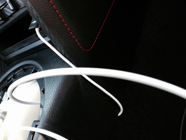

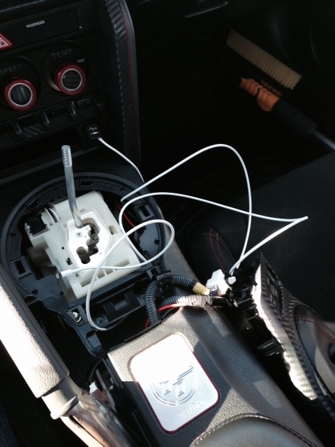

Next, remove the ebreak boot and unscrew off the shifter knob. You will also need to "pop" off the shifter bezel to access the space under it. I pluged in the USB end of the cable into the USB drive, then "snaked" the cable around the side and up untill I could see/reach it.

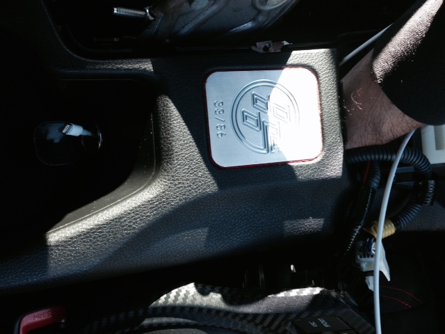

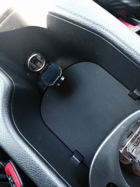

Next, Look into the middle console and you will see the 12V popwer port. You will notice that there is a small rectangle opening on the bottom of it. This is where you will reach inside through the shifter opening and guide the small end of the USB cable into that opening. I have quite big hands but I was still able to do this.

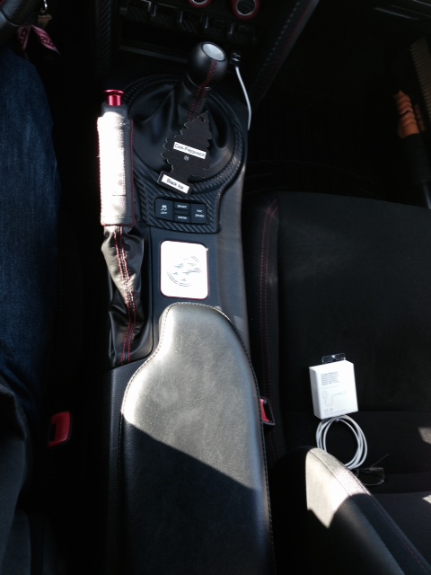

I have a Sutty arm rest and it really helps cover the middle. The OEM armrest would look good, too!
Attachment 57744

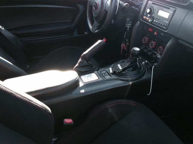

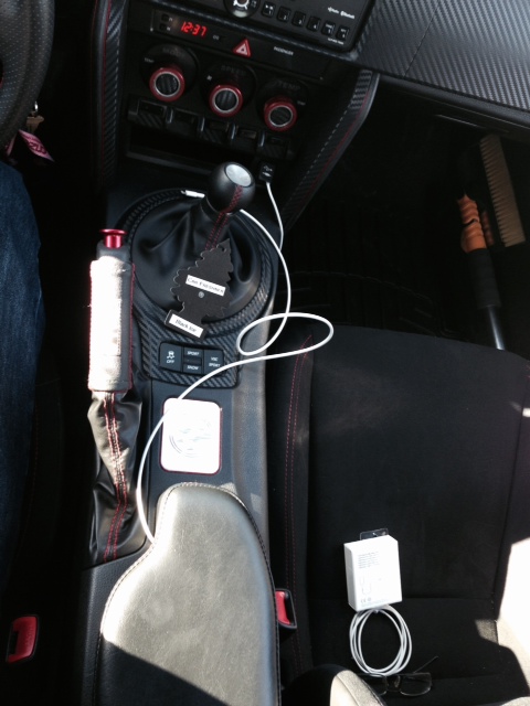

I do use my phone for GPS and I wanted to make sure that if I needed to see the phone, the cable was also long enough to reach the other side of the shifter so it would "stand up" while I drive. This just shows you the reach the cable can go.
Attachment 57745
This is the passenger side view. I could make a hole and have the cable be tucked away up much higher, but this is just the way I did it.
