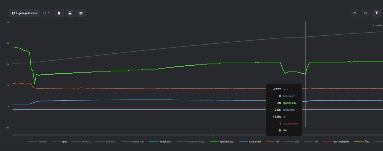

I did some data logging with my OFT tablet. Two pulls in 6 gear, one in 5 gear, and a 2000 RPM to redline in 3 gear:

As you can see, the problem seems to appear only in 6 gear and it seems like what I'm feeling is a one second drop in Ignition Adv. (27 to 18).
The Advance Multiplier stays at 1 and FLKC is 0... I did two runs full throttle on 6th gear and the first time it happened at around 4400 RPM, the second time it was around 4200 RPM. Didn't happen at all with the 5th gear.

open the tune with romraider
open vvt intake tables
change values that are 40, to 39

Either some strange settings in tune tables
Or maybe it's dropping into low power mode running Ignition vvt off (base timeinig A) table instead of ignition vvt on ( base timing B table )
This may be due to a cam error caused by the vvt system being used to it's limit
Do as tommbrz says and take a degree or two out of the max values in cam tables
