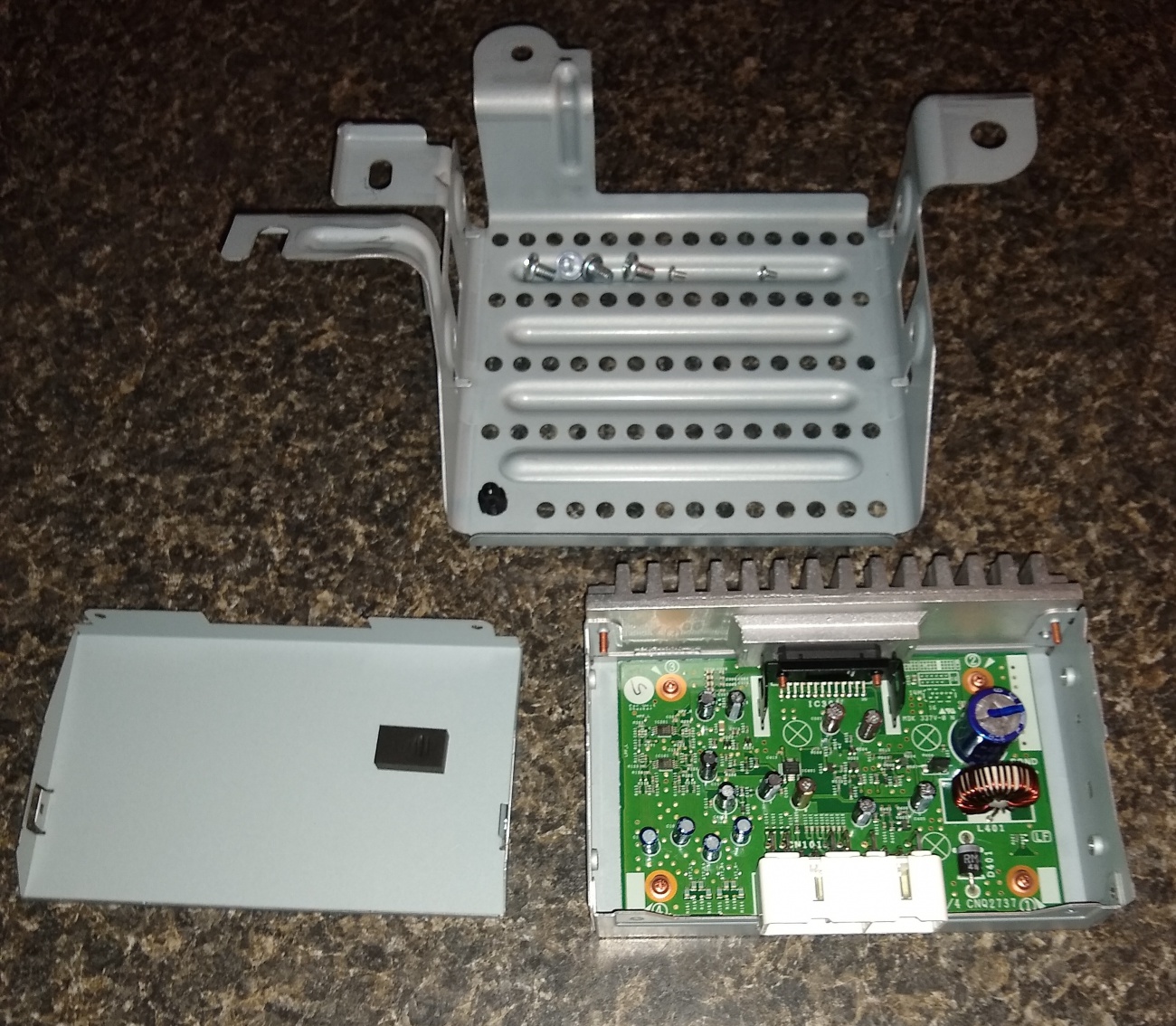

Here are a few pictures from different views with the bracket removed:

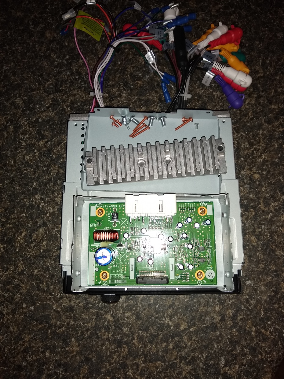

Here it is with the top panel removed:
And a closer view of that:

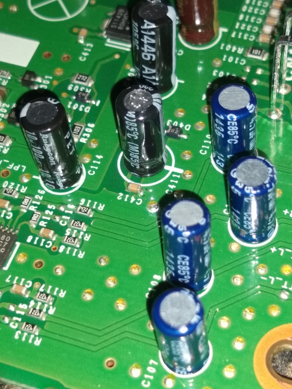

And with the circuit board removed from the housing and flipped over:
There are no switches and no adjustment potentiometers on the circuit board at all. It is matched to the factory head units that utilize it. If you find that your amplifier is not plugged in and has a bypass plug installed in the signal input/speaker output connector instead, then your OEM head unit does not provide a 12-volt signal to turn this amplifier on and it is powering your door speakers directly along with the dash mids and tweeters.

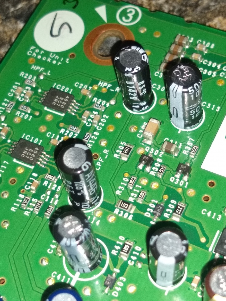

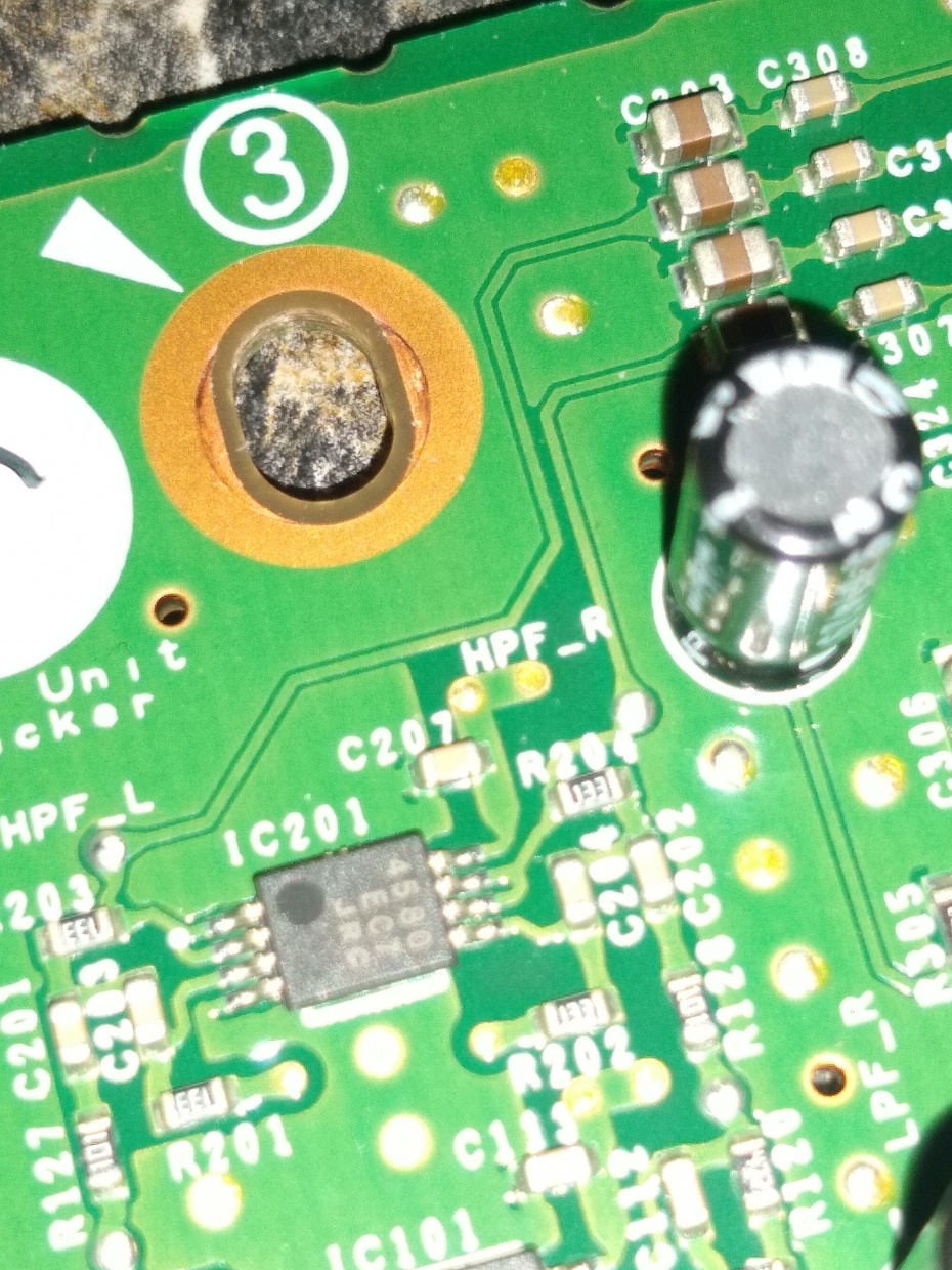

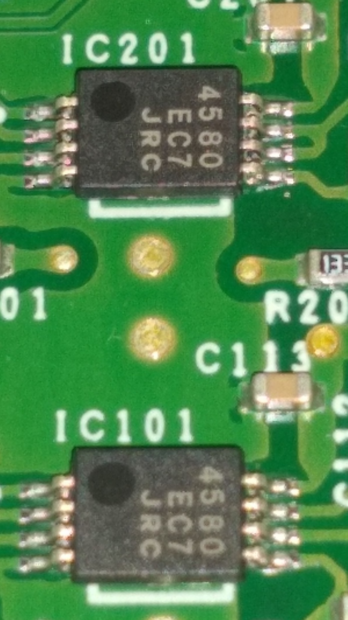

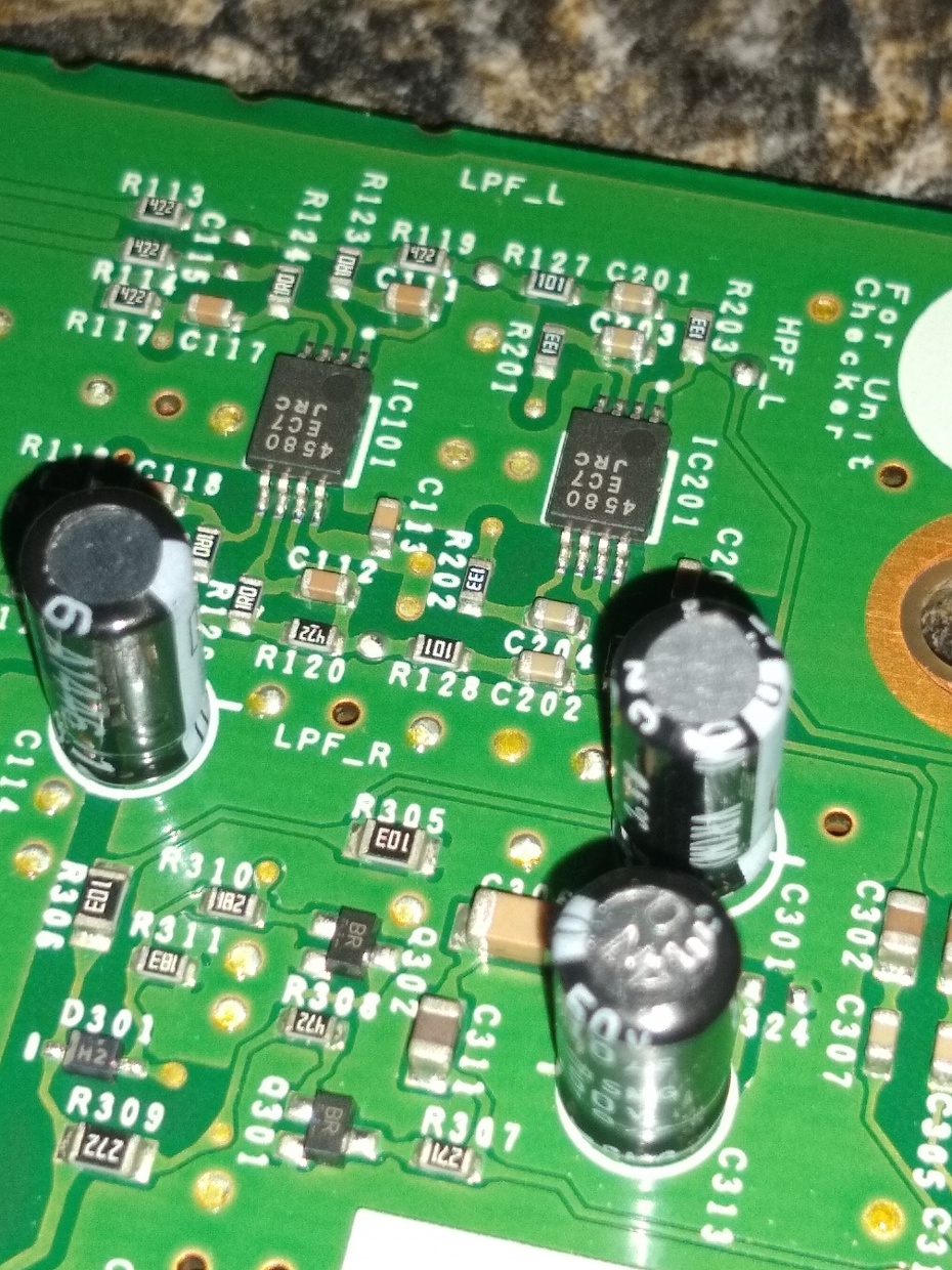

top left corner is labeled "HPF" and "LPF". can you read the model numbers of IC 101, and 201 chips in those area's?
it would seem to indicate the top one is a HPF/subsonic filter, and the lower one is a LPF.
that is where any alteration of crossovers is going to happen, or at least knowing what they setup the oem crossovers at...
i love how they nicely labeled everything!

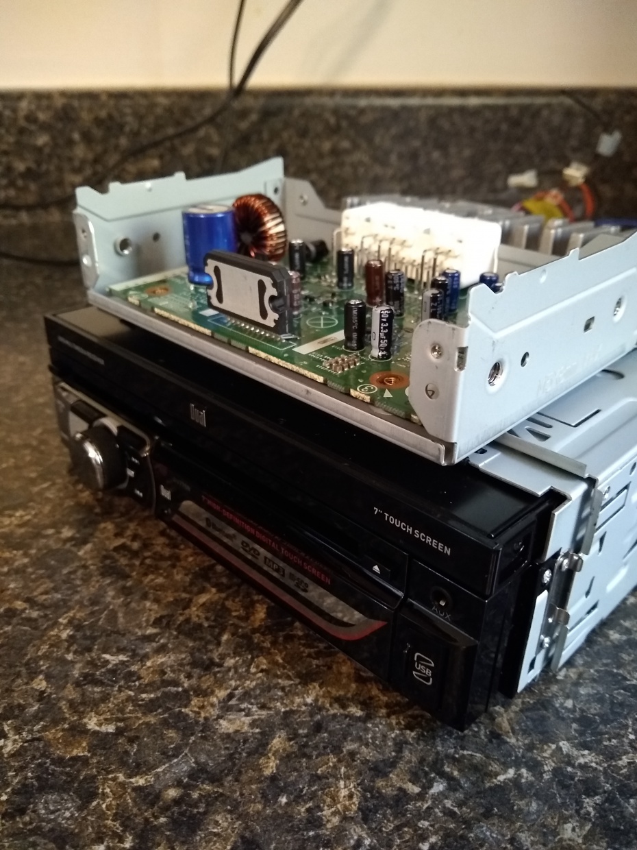

Seems pretty empty for such a big box...
Here's a better close-up of the two chips.
Looks like they both read
4580
EC7
JRC
Originally Posted by Mr.ac View Post

RC4580 Dual Audio Op-Amp
Here is the full data sheet for the Texas Instruments version of the chip:
https://www.ti.com/lit/ds/symlink/rc4580.pdf
The RC4580 device is a dual operational amplifier that has been designed optimally for audio applications, such as improving tone control. It offers low noise, high gain bandwidth,low harmonic distortion, and high output current, all of which make the device ideally suited for audio electronics, such as preamplifiers, active filters, and industrial measurement equipment. When high output current is required, the RC4580 device can be used as a headphone amplifier. Due to its wide operating supply voltage, the RC4580 device can also be used in low-voltage applications.

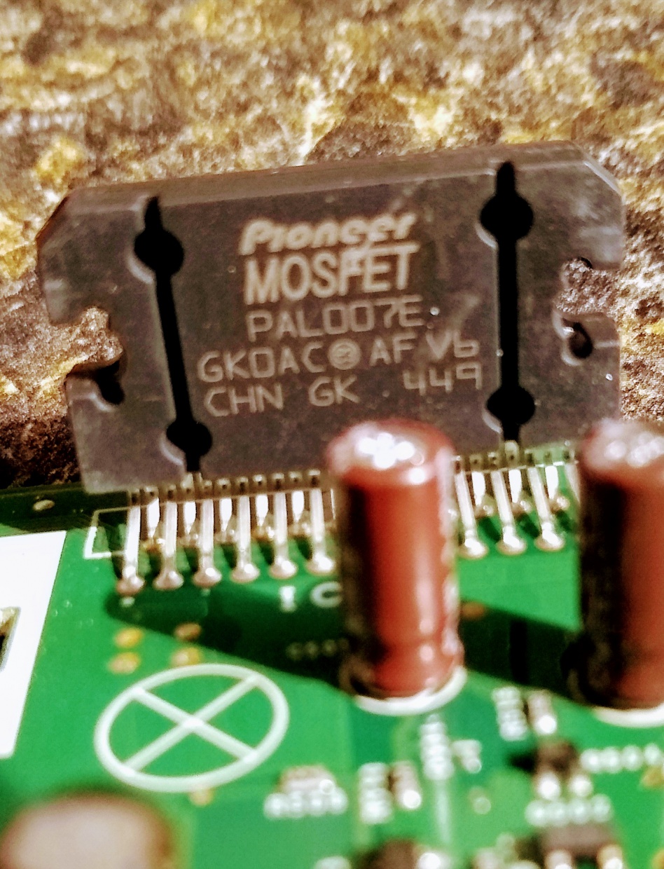

As @soundman98 observed, the secret to modifying the input filters will likely be the components associated with these chips.
@FR-S2GT86 - Any possibility of getting a number for the main power amp chip, IC301, the one attached to the heat sink?
FYI - Regarding the power output chip:
https://datasheetgo.com/pal007e-pdf/
http://www.datasheetcafe.com/pal007-...osfet-poineer/
The PAL007E is a breakthrough MOSFET technology class AB audio power amplifier in Flexiwatt 25 package designed for high power car radio.

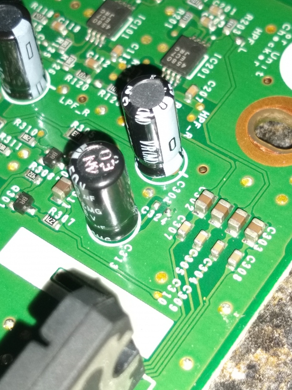

The input attenuating resistors are reducing the speaker level input signals down to a level that the op-amps can deal with.
The input filter capacitors appear to be a subsonic filter that is certainly protecting the op-amps from any DC voltage that may be present offsetting the input signal. They may also be rolling off some of the very low frequency audio depending upon their value.
Figuring out how the circuit is configured is one matter but coming up with any modifications that can be implemented by mere mortals might be a whole 'nuther matter.

Had to de-solder and remove the heatsink brace from the board to get a look at the numbers on the IC301 chip, but here it is, as requested.

And the different angled close-up views of the filter area on the board as requested.

Here is a good close-up of the input attenuating resistors as well, just in case someone ever wants to replace them with a potentiometer to act as a gain control for a future system integration project.
*Edit* These attenuating resistors are 8.2kOhm, as the code on them indicate and as I personally verified with an ohmmeter.
It's really not that big of a box. The whole thing could easily fit inside the shell of a standard DIN sized radio.

i've been staring at those pictures for the past hour. i'm still no closer to understanding how the circuit works. part of me thinks that ti datasheet isn't correct, but at the same time, the pins make perfect sense.
it really looks like a single bypass capacitor is all that's controlling each channel on the op-amps(LPF, C111 neg L, C117 pos L, C112 neg R, C118 pos R). what's weirding me out is how the 'out' and negative pins are tied together on the HPF section. almost like it's converting a positive input signal to a negative signal for the pioneer amp chip...
Are you referring to what would be RF in the diagram below? If so, if I recall correctly, RF (the Feedback Resistor) in an op-amp circuit is used in conjunction with RG (Gain Resistor) to determine the overall gain of that stage. If RF is zero (a short circuit, just a piece of wire) it sets the gain to unity or "1". This would be appropriate for a buffer stage or one that is doing signal shaping (filtering, tone control) rather than an actual "pre-amp" function. By connecting Vout back to the inverting input they are creating "negative feedback" which makes for a very stable circuit configuration.

We can probably figure out the circuit topology and the resistors are clearly marked on their top sides. Unfortunately, the capacitors are either unmarked or their markings have all been very consistently placed face down prior to soldering. You can sort of guess at a range of values based on physical size but if they are truly unmarked they would have to be unsoldered and measured to determine the actual capacitance. Almost like it was intentional . . .
