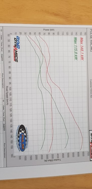

Punch out OEM header.
OFT catless header tune and OFT the coldstart away.
Cost: 1 x OFT, 3 x gaskets.
LOL, torque dip.....��.........��

Debatable IRT "dip", depends on alot of variables.
My decat OEM header has a low in basically the same spot.
I run Ecutek and my tuner has 20 odd years experience with it.
I find that when cruising around in the "dip" my fuel economy is excellent.
When I'm "up it" it's never near the "dip" anyway.
Opinions may vary
