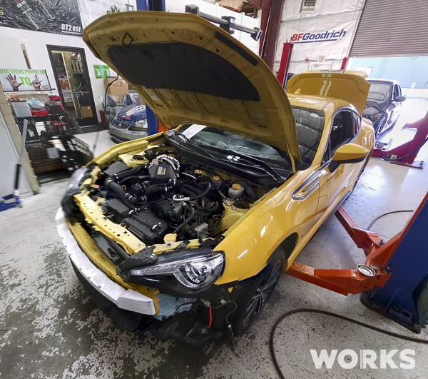

Putting up pics soon.

Mr_YUzU_FRS is offline   Reply With Quote
