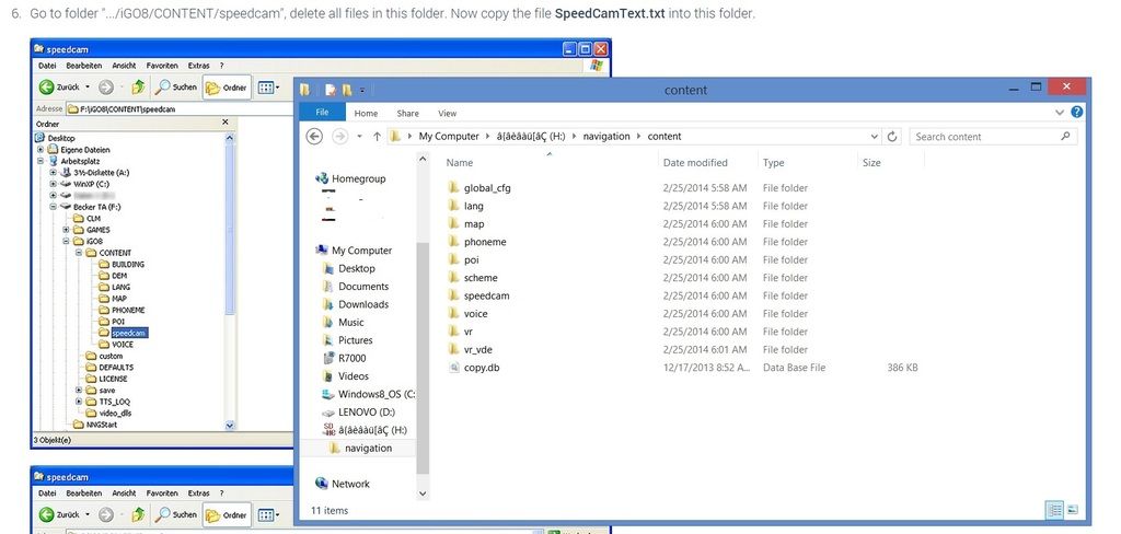

For the 2013-2015 fujitsu ten head units, you'll want to download the database for the Becker Z (by Harman) model here: http://www.scdb.info/en/plugin-becker-z/
Follow the given instructions, it's super easy. The file system is pretty similar to our devices as well.

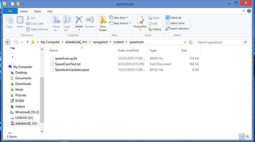

1) plug in your SD card to your laptop/card reader
2) Navigate to [SD DRIVE]:\navigation\content\speedcam
3) Delete the stock file, and replace it with the downloaded one. Do not rename it yourself. You can see the data format is all coordinates (LAT/LONG) and camera type.
4) Properly eject the SD card from your computer (don't be lazy, nobody wants a corrupted map SD card)
5) Plug back into your head unit. It should use the .txt file to make it's own database, which looks like this if you want to verify that the installation worked:
I would ignore step 9 on the website instructions. It worked perfectly fine on my headunit without doing it.

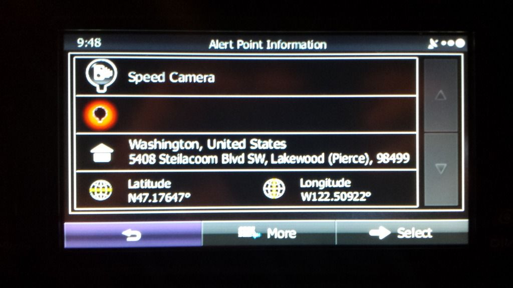

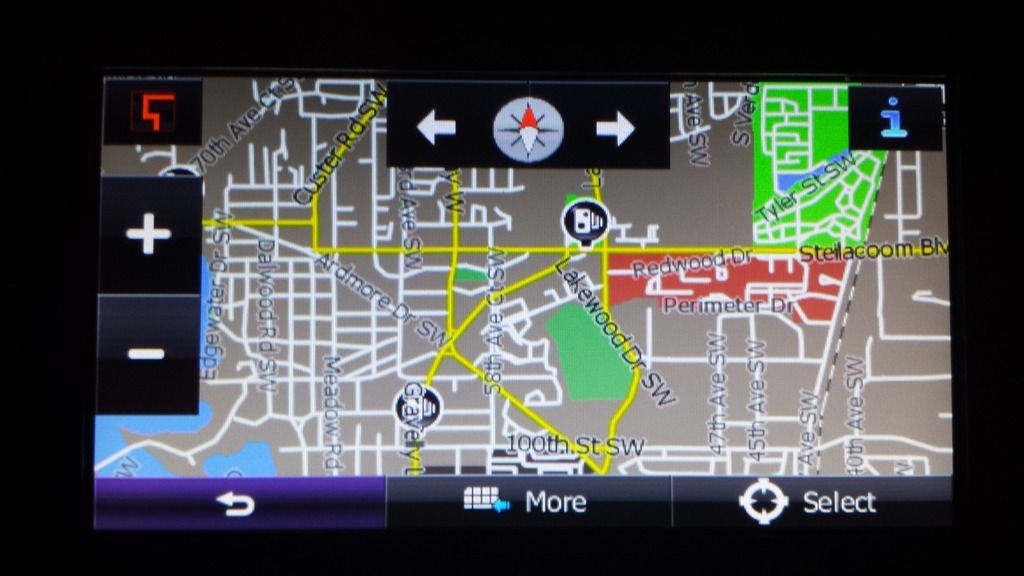

After I first plugged it in, I went and turned on all the visual/audio warnings. Then I checked out the map while parked in my garage, and was delighted to see it worked perfectly on the first try. Here's where I got my ticket!

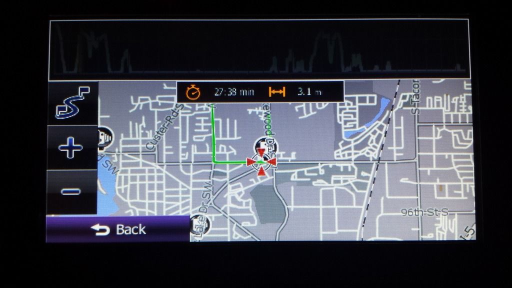

No surprise, using the trip log, it was immediately after a right turn with no prior warning:
But enough bitching, if you tap the camera icon and hit the i button in the upper right hand corner you can check out the information for a given trap
