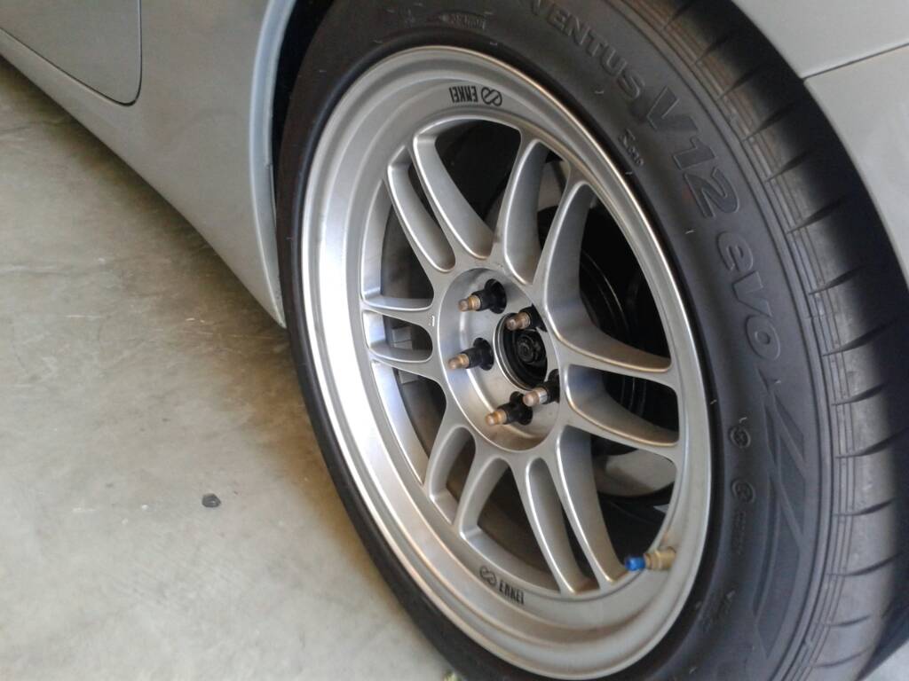

Size:  71.7 KB get arp wheels studs there easy to install
OmarYasin is offline   Reply With Quote

Originally Posted by OmarYasin View Post
Attachment 92302 get arp wheels studs there easy to install
are those muteki open ended nuts?
BRZ RN is offline   Reply With Quote
Yes
