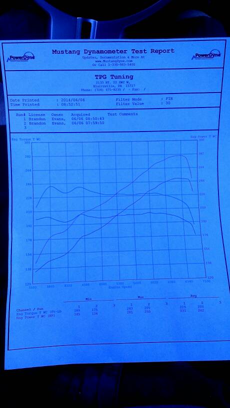

Greddy kit dyno sheet
Here are my new #'s after having some new stuff put on and tuned.

My bad dyno sheet pic turned out bad will try another later that is actually legible

Tried lightening it up a bit

Looks the same to me. Not bad numbers on 93 octane. Dat torque curve. It looks like you made 281 hp and 243 ft-lbs. My guess is that you are dropping a couple PSI past 6300 RPM which is when the torque starts dropping and why you didn't end up making a larger horsepower number.

The 281 is on e85

250 on 93

93 it's 7-8lbs of boost and on e85 it's 11-12

You can definitely run more boost than that on 93 octane and on E85 before that turbo will run out of steam.

It seemed low coming outta there, it was a mustang dyno for what it's worth

i wouldn't worry about the dyno, you should have been in the 10psi range on the 93 and the 15-20psi range for the e85... roughly.
At least this is what i've found in my research.
