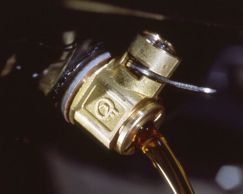

I hate to tell you to change your oil again for a third time, but I would recommend a Fumoto valve. Tool less oil changes, leak free, no need to locate a gasket. I bought one for my BRZ to try it out and now have one on both of my cars. I also recommend it to everyone I know who changes their own oil.

Installing the Fumoto valve may be a option, it has a lower torque rating (made of brass, not steel), but it uses a fiber crush washer that may better conform to surface irregularities. And you have the benefit of never having to remove it.
