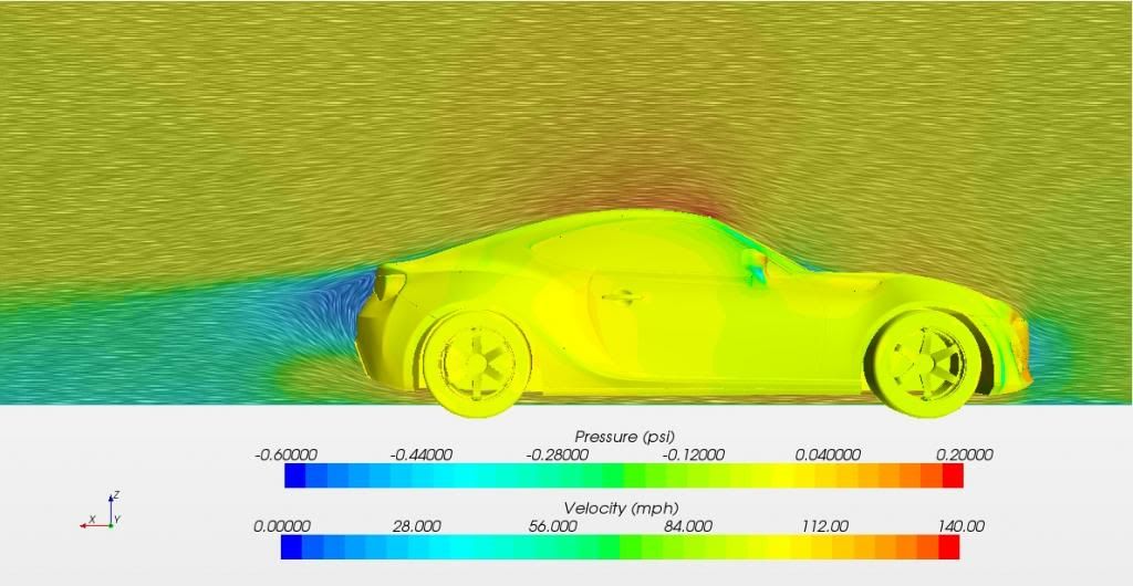

Old 03-17-2014, 10:34 PM   #14
plucas
plucas's Avatar
Drives: Subaru
Location: Everywhere
Posts: 185
Thanks: 117
Thanked 227 Times in 103 Posts
Mentioned: 32 Post(s)
Flow stays attached to rear glass pretty well without anything. No vortex generators needed. I could make some assumptions about a roof spoiler, but it would just be an assumption.
The picture below shows how the fluid stays attached
plucas is offline   Reply With Quote
