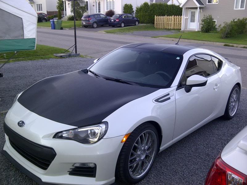

I went 16 to get an oldschool look. kind of a trip. these are my current summer wheel
and this is what i will put this summer
The problem with RE-11, is that in canada... it's 280$ + tx each.... and since i already have 3 other sets of rims with new tires, i don't want to spend that much... but maybe i wont have other choice..
i was kind of affraid that with beefy (if I could say beefy) tire like 245 it wouldn't fit, because it already seems pretty near fenders with my 225/40/18 on 18x8 rims that have the same offset...
Walla Walla is offline   Reply With Quote

He says he wants the old school look (yet with a carbon hood?)
245/40 will be around 1" shorter than stock, and will look goofy.
hehe, photo don't show it correctly, but it is not carbon fiber, it is a brushed metal/black hood vinyl.
if it doesn't fit wit the look, it will go away
