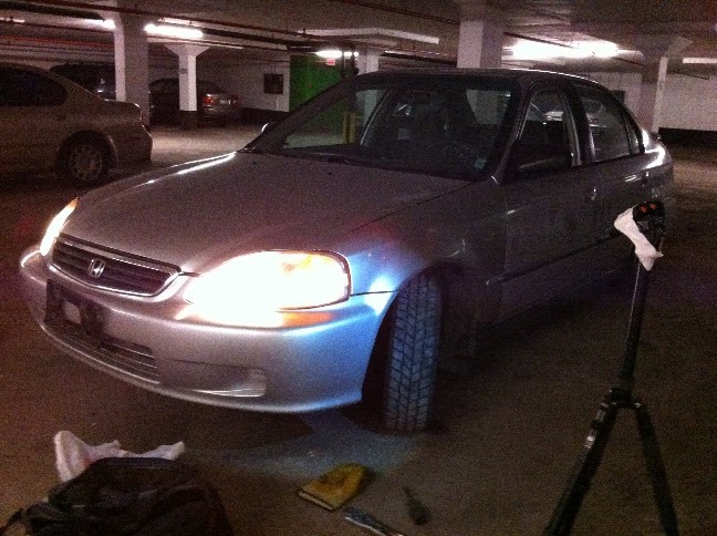

UPDATE PICTURES!
Before
During
After!
and all done within the underground parking complex of my apartment building haha.
....still have the sound tho. I'm starting to think it's one of the pulley's rubbing against something.
