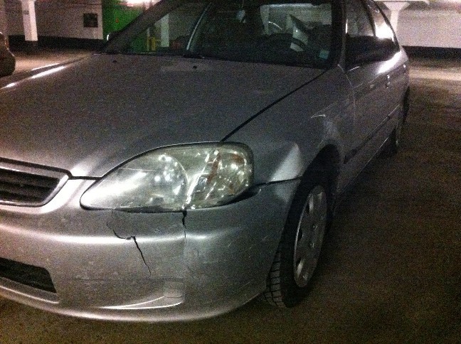

UPDATE PICTURES!
Before
Attachment 29870

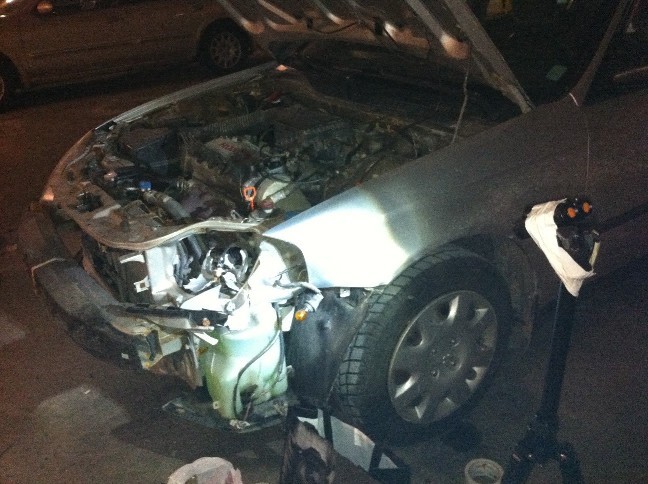

During
Attachment 29871

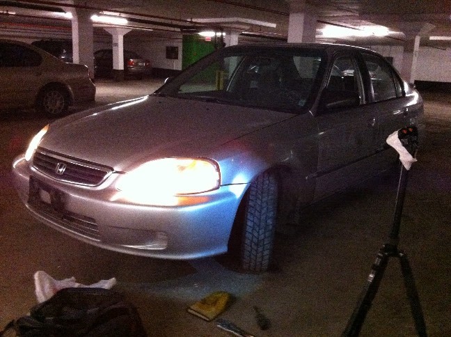

After!
Attachment 29872
and all done within the underground parking complex of my apartment building haha.
....still have the sound tho. I'm starting to think it's one of the pulley's rubbing against something.
