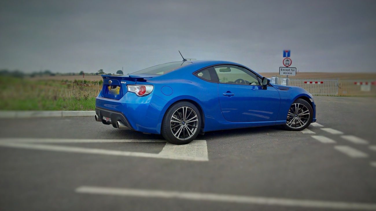

I have them on my car, they come in a standard drop, however I do recommend a wheel alignment and camber bolts up front.. make a big difference...

My car sitting on Eibach Sport lines.
