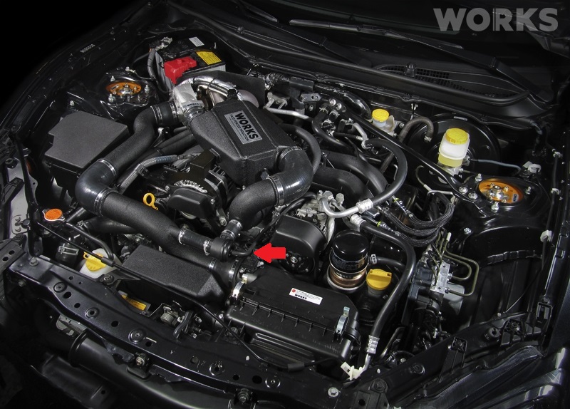

2. On the boost gauge, where do I tap into with the vacuum hose going to the gauge? I have a works stage 2 kit. Can you put a T right after the diverter valve on the line that goes to the brake booster?

2. I installed my T into the PCV line going to the brake booster. Check out my YouTube page iracetv for my gauge install.
