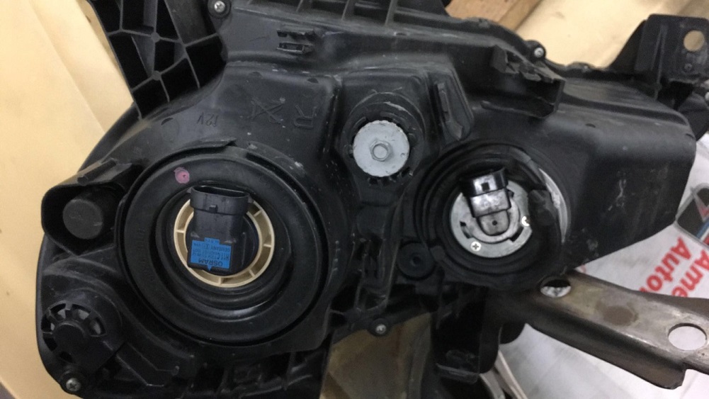

So I bought Spyder headlights for my 13 BRZ and I'm completely lost on how to hook them up, I'm guessing I'm missing a ballast or something because When I bought the car it came with the stock FRS headlights. Below is a link to the lights I bought and 2 pictures of the connections. Picture 1 is the headlights connection and picture 2 is the 3 connection the car has. Any help would be appreciated it. Thank you

Are you sure that's the headlight connectors in the bottom pic? They look like 2pin connectors so can't be right. The triangular 3 pin connector is one of the correct ones, it will connect to the level motor. Check under your stock headlight the connector is usually there

sounds crazy but it is right, here's a picture of the lights I took off it, you can see the 2pin connection bulbs that they plugged into

I think what I need to do is buy a 8pin pigtail to plug into the headlight, and use the diagram below to cut the 2pin plugs and wire them to the 8pin

You need to follow those 2 pin connectors eventually they join into a single connector. Which is 8pin for brz and 6 pin for frs.
But if previous owner has installed frs lights it was probably custom and the cable may have been removed.
