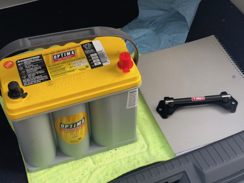

Old thread, but reviving. I have ordered the Optima Yellow Top 51R, which has similar dimensions to the TRD Battery Bar. I will maintain the battery also on a tender/maintainer when not used for an extended time. I have always wanted to use my TRD Battery Bar to accentuate the matching strut bar.. I do have the smaller TRD Battery Bar, which supposedly fits the JDM Panasonic battery with a 127mm width. The Optima is anywhere between 126.49/128 mm and so I'm hoping it will be fine. Pictures to follow of install. Maybe I'll make it a DIY if there is a demand and of course if it is successful.

Thanks for the info... Just so you know, the TRD Battery bar needs a 51R Battery Group due to size.
The Group 35 batteries you list will not fit it.

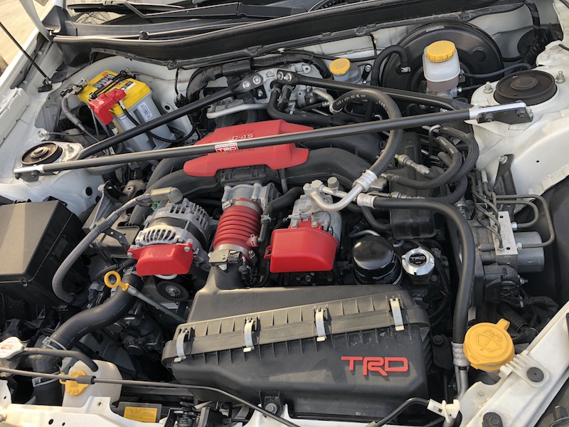

Cool Installed TRD Carbon Battery Bar
Installed the TRD Carbon Fiber Battery Bar.
Matches the Carbon Fiber Strut Bar.
Looks nice next to the other TRD tidbits...
Have to look into the JDM battery plastic holder to ensure proper fit.
Also need an JDM hold down bolt.
Otherwise, very clean and the yellow top matches the rest of the yellow caps/cover.
