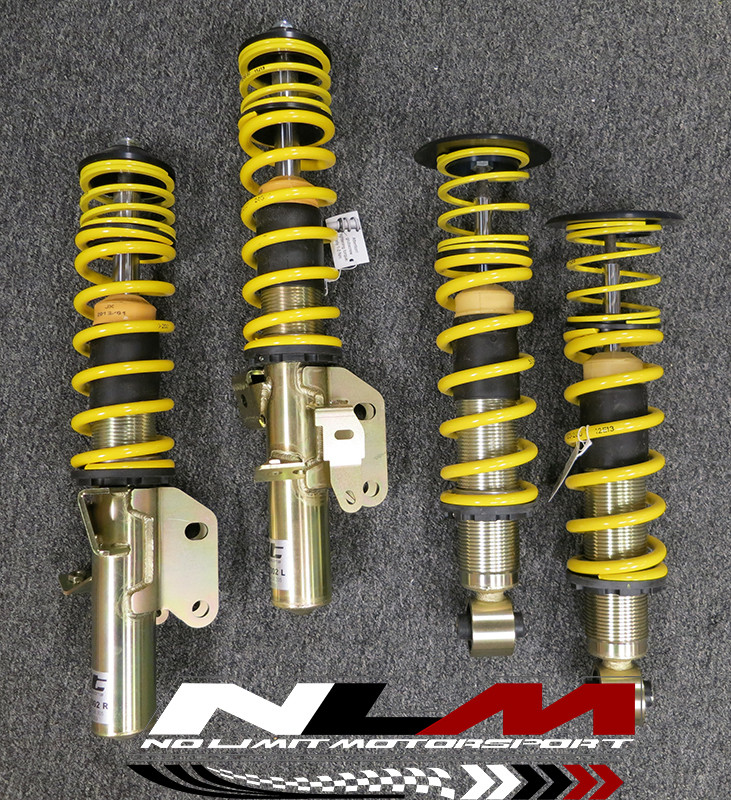

Sorry for the noob question, but would you guys be able to confirm for me that the black metal collars you see in the picture just underneath the top nuts are meant for shipping only? Their not new spring seats that need to be installed are they?

Those are the new spring seats, and you want to keep them in place.

So I bought mine secondhand and didn't realised until now that they're missing the rear spring seats. Do you think I can get away with using the stock rear seats?
EDIT: nvm did some googling and I definetely need them since it centres the springs. Time to email ST I guess lol.
