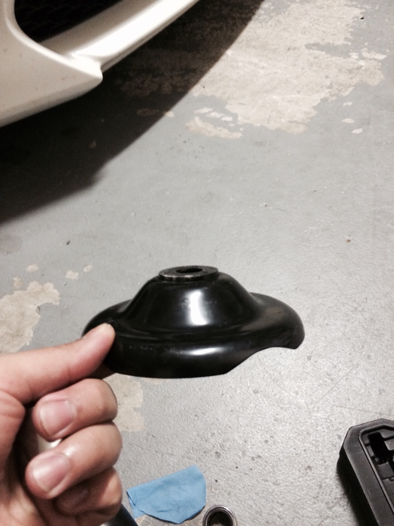

2nd: for the front do you need to put this thing, kind of a plate that came off from the stock that holds the stock spring? It was in between the top hats and the front coilover?
Attachment 108014
Do i do the same in rear? Because it had that plate also from the stock struts.

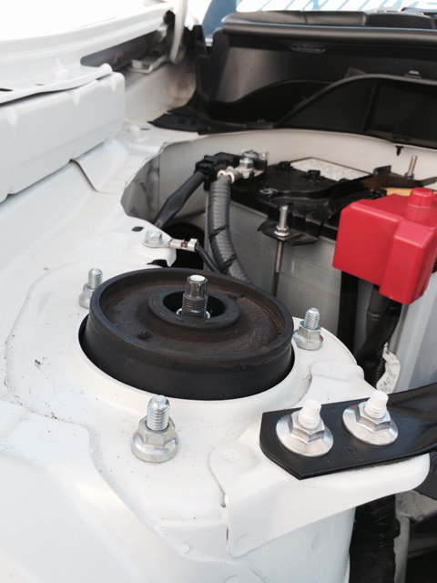

3rd: do this look alright or is it to high? That's w/o the plate i'm talking about in the 2nd question.

2- nope. dont need that for the fronts.
- for the rear, theres only one "piece" for the top hats in the rear. you need to use that or there'll be nothing to hold down the spring... it should make sense when you look at it.
3- yes. it sticks up higher than the stock strut.

damn, i reused that plate for the front. nothing weird is happening so far. should i take it off?
wparsons 04-29-2015 10:04 AM
That's the stock spring seat, and is just taking up space now.
dito 04-29-2015 04:39 PM
so should i take it off?... lol I'm nub
8R6 04-29-2015 07:33 PM
yes
jimmillion 03-28-2016 03:11 AM
Originally Posted by 8R6 (Post 2231946)
yes
Sorry for the noob question, but would you guys be able to confirm for me that the black metal collars you see in the picture just underneath the top nuts are meant for shipping only? Their not new spring seats that need to be installed are they?
wparsons 03-28-2016 07:32 AM
Those are the new spring seats, and you want to keep them in place.
Tor 03-28-2016 08:04 AM
1) Tighten down the first nut to the specified specs. Install the second nut to prevent first nut from loosening.
2) The springs are different diameter than stock. Remove the the stock spring seats front AND rear, and replace with what came with the kit.
