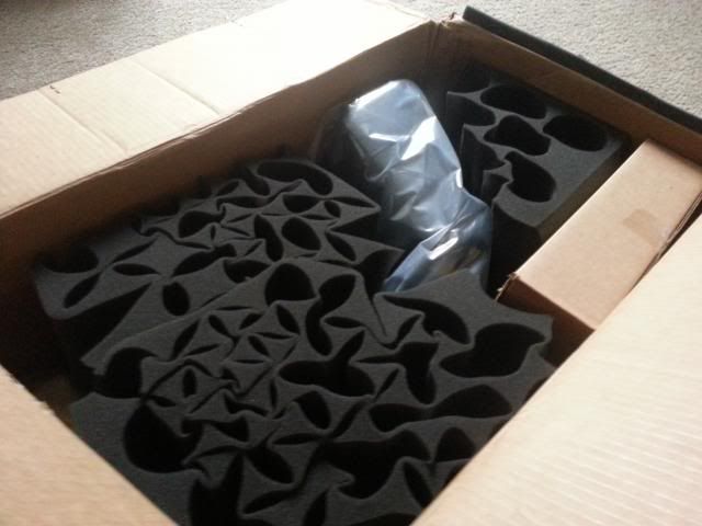

Box was shipped UPS ground, over 9 stops as it shipped from NC to AZ.
Box was in good condition. They used a strange packing material. Everything looks pretty professionally packed and built.
The box itself is a smooth piano like finish on the back with the textured oem feel on the front. Very sturdy build that feels dense and not flimsy.

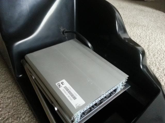

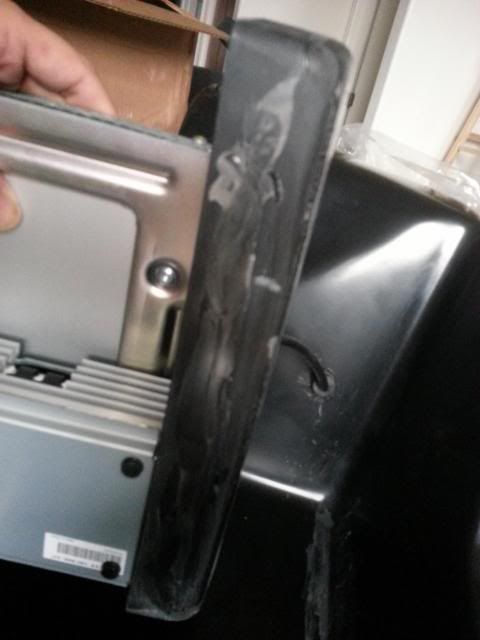

Right off the bat I found the amps which are attached to eachother had come detached from the box. It appears they are attached via an adhesive which seperated. It also appears when the amps came off it hit a cross bar and knocked it out of the hole it was mounted in. I will be contacting them via email to see how to deal with that. UPDATE: After contacting Toyota Parts Outlet they were able to get a hold of OEM Audio. OEM Audio FEDEX overnighted me a complete setup. Great customer service plus a follow up call from OEM Audio to make sure everything worked out for me.

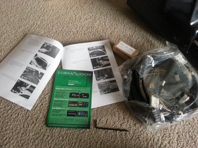

The cables are very well built with labels on each of the connectors. Package even includes zip ties.
Instructions are nicely printed and not cheapy photo copies and look pretty detailed. There is also the color flyer that describes the head unit setting you should be set to. I'm glad they included this as I have been wondering about it. It doeas say to set it to natural and in TC mode.

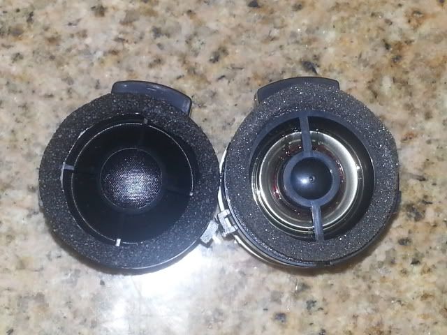

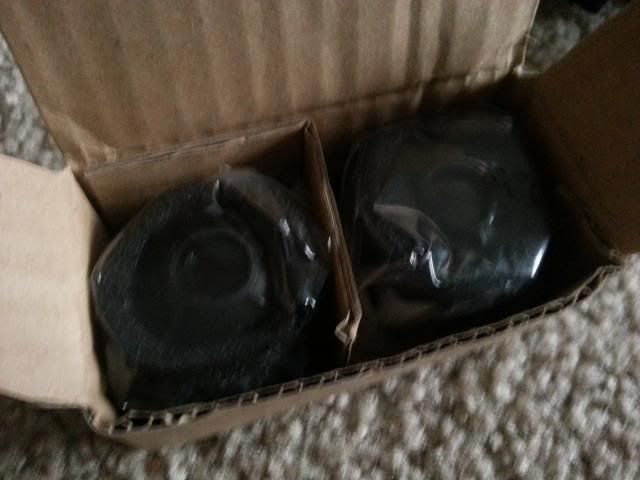

Tweeters feel heavy and come in a cheap Chinese looking cardboard box.
Here are some comparison pics of stock tweeters vs the oem audio. The oem are actually smaller in overall size but make a hella difference. The stock ones have the white back on them.

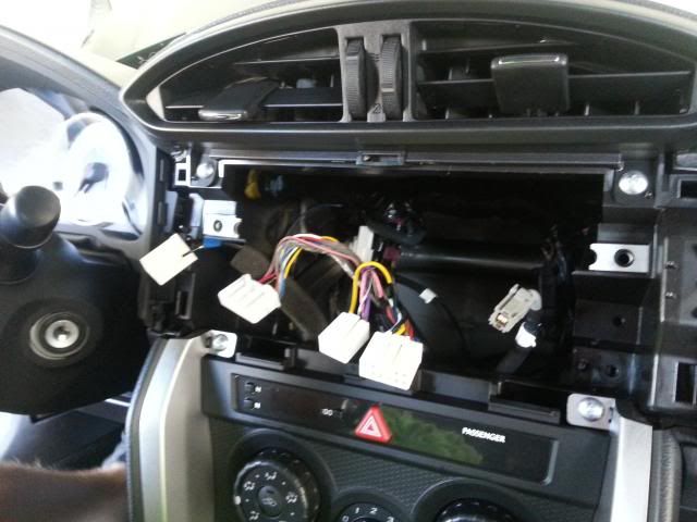

Removed the stereo plate which was much easier than I thought. Used a microfiber mitt to cover the shifter knob
Big hole in the dash now

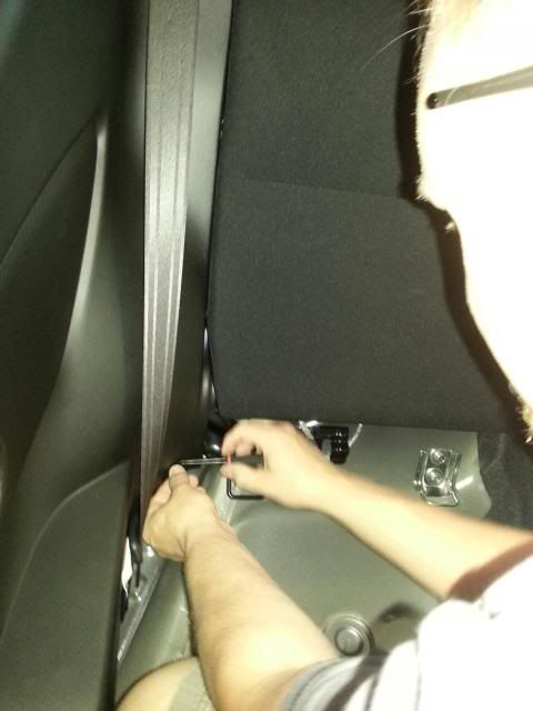

Removed the back seats. Front is an easy 10MM. The back of the seat has to slide down about an inch to release it from a hook that is in its foam. I put my fist on the back of the seat and pushed down. Install was easy as grabbing the seat and using my thumb to push the seat further down to get it hooked.

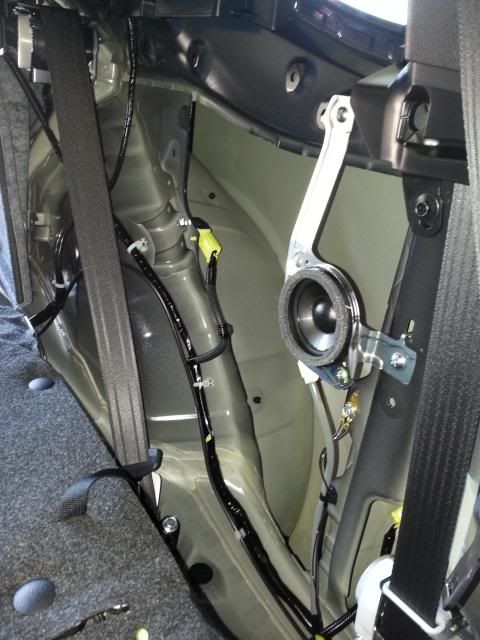

Just more pics if anyone is interested in what the panels look like or the massive holes behind the panels. If I do sound deadening I will be doing the wheel wells for sure

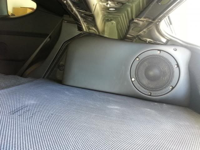

Finished with the back

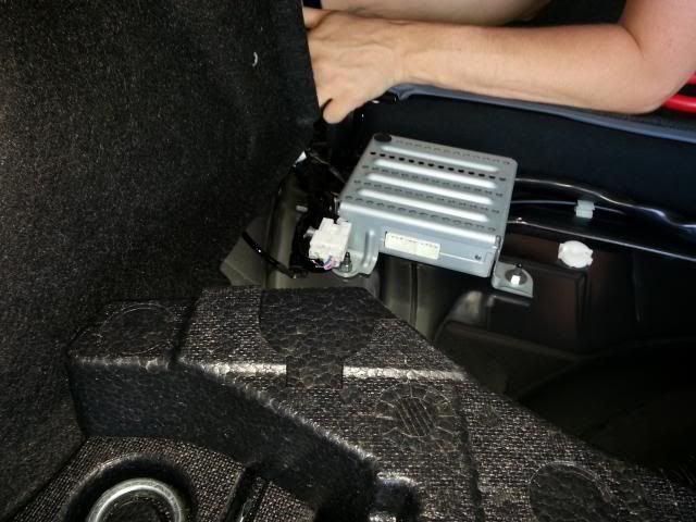

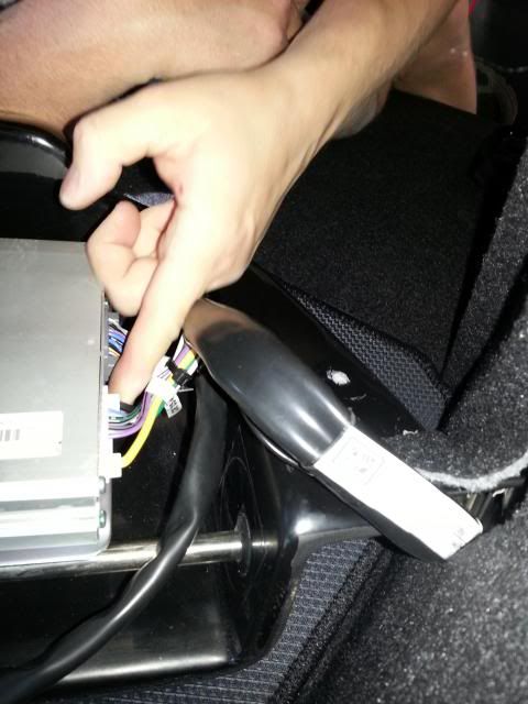

So the instructions were wrong here. Installing the plugs into the amps the instructions say the white plug on the harness goes on the top. It appears they change the design and no longer put the larger amp on the back side of the plate but flipped it so it is the first amp you see when looking at the box from the back. You cannot mix up the plugs since they are different. They may look the same but trust me they will not fit.

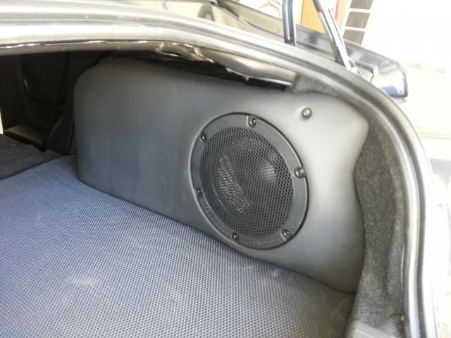

Box is all plugged in and installed. Yes I have my trunk carpet flipped. For those that do not do that its much better. Does not allow things to slip around and is spill proof that way.

All of the OEMAudio+ BRZ/FRS system owners that I've talked to all received have their units with the amp bracket coming un-glued from the box. If that's the case, don't sweat it, it's an easy fix. @Yruyur's damage is more extensive than usual from what I've seen. On his it looks like one of the support bars as well.
I'm not sure how expensive it would be, but they would probably be better served looking into a styrofoam mold to replace their current packing foam medium.
