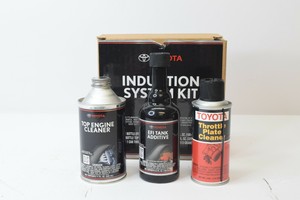

My Subaru manual says every 15.000km it needs injector cleaner, but as local dealer doesn't stock it I did a search and found the following.
In USA there are two different kits from Subaru and Toyota (SOA868V9150 & 00289-INDKT) that clean intake, throttle plate and injectors, unfortunately none available in Europe.
There is also available a carbon cleaner SOA868V9165 through Subaru and Toyota that needs a special tool to apply it through an intake vacuum hose.
In Australia there is a top engine cleaner SA459, sprayed directly on intake vacuum hose along with a fuel additive.
Finally in Japan Subaru sells a PEA based (75% poly-ether amine!) injector cleaner K0879Y0010 as fuel additive, which is the strongest available product on the market in it's category, but expensive too!
Interesting, almost all Japanese manufacturers have their own PEA based injector cleaners from the same Nippon factory, as it's the most powerful ingredient in every effective intake/injector/engine cleaning product.
I decided to follow this path but Subaru PEA isn't available outside Japan as it's extremely flammable. Fortunately the HKS DDR 52006-AK003 is the same exact product available from some e-shops.

Techron isn't as good as the original Subaru PEA for sure, as my dealer is also Toyota dealer he puts a Toyota injector cleaner every 15.000km in my fuel tank:
