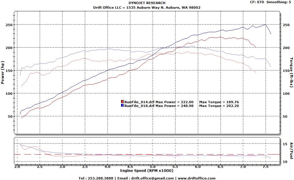

Attachment 71828
^^^ 1) Remember that cold snap we had in Jan? Yeah, that "hell freezes over" weather? Well, the ambient temps in our dyno cell were close to freezing and we did a Vortech 10PSI calibration. This was the result (with 92 Octane). I've plotted it along side the other VT 10 PSI run with the HKS EL header for comparison but you now can see how temps can really skew your results. I didn't put this into the lot simply because I didn't feel that it was indicative of the kit and it certainly wasn't repeatable in warmer temperatures.
Attachment 71839
^^^ This was an excruciatingly trying kit and amidst frustration following the install of the intercooler (and Raceseng 70mm pulley) for the Innovate kit, I had experienced all sorts of issues (or quirks) which we now know to be related to using an aftermarket OMNI MAP sensor. After conferring with @moto-mike , I was glad to know that I wasn't alone in this and being drained, I had Moto-East throw in one of their E-Tunes and finished the calibration after some logging on the dyno.
The point to be made in this last case : More costs (intercooler and pulley) and for a mere 20WHP and 15#s TQ difference makes this one of the worst price to performance options out there right now. Given the prices of the kit with the intercooler today, you'll be in turbo territory and hence have a wider and better range of performance offerings at your disposal. If you however choose this kit, I'd strongly suggest you hit @moto-mike up for one of his awesome dyno-proven calibrations!
