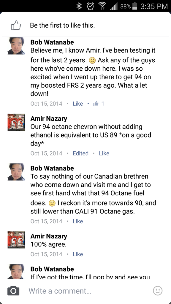

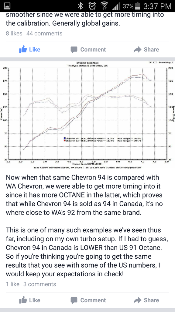

And was specifically talking about the 94 octane in BC being crap. May not be the case out east but here is some evidence from Bob, who has tuned almost every 86 in the north west, also Amir, who owns the only gas station in bc that sells e85
But back to the OP a good dyno tune using ecutek would get the most out of your car, but the difference between 93 and 94(if actually 94) would be tiny.

Yeah, all other stations here are 91 at best, other than Chevron 94. But all of the 'premium' grades don't have ethanol in them. But cross the border to Washington state, their 92 does have ethanol and is far superior.. At least when it comes to knock resistance.
