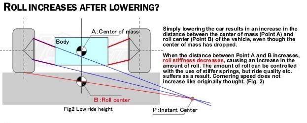

Originally Posted by tptwrc View Post
I'll prob just drop 1in...The car is pretty low to begin with. Add splitter, side skirts, defuser and I'll be asking for it if I go any lower lol
Hahaha! Yeah no kidding. Any lower then an inch your really have to start worrying about roll centers and all that. I look forward to seeing your car when its all done
edit: also try and match your areo and spring rates for the track unless you are just doing it for looks.
Old 12-29-2015, 01:33 PM   #11
Tell me what that means!...I'm really trying to avoid putting a big wing out back. Figured if I can create enough low pressure under the car then it would help.
roll center or spring rates and areo?
With areo your car will forced closer to the ground at speeds you should know that much already, but what that means is less travel in the shocks and you will likely ride your bump stops if the spring rate is too low (not stiff enough to resist the downforce) and that is very bad for handling. It is also bad to go too stiff haha its a fine balance and all depends on what your doing with the car.

So more Aero needs higher spring rates...makes sense....My goal is to run as little down force as I have to since it slows your top speeds
