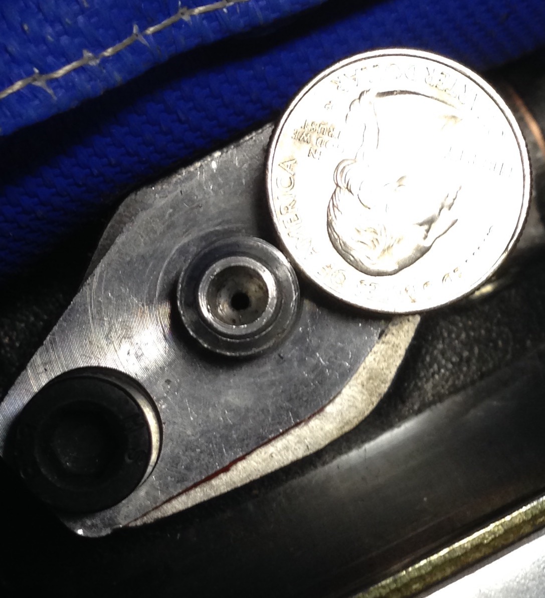

If this pic loads this is what they sent for the feed line adapter on the turbo
Hmm. Honestly I'd have to look at mine again when I get my car back. I can't recall how wide that feed fitting is on mine. I just know my oil seals blew, and the oil restrictor got here after the car was already in the shop for other stuff. I went with a new turbo (plan from the start anyway) so hopefully they didn't throw out the old fitting.
I'll recheck mine for you when I can. I should have my car back next week at the latest. Here is a picture of the restrictor. Couldn't find a quarter, so its a Canadian $1 coin (similar size as a quarter) and a Dr Pepper can for reference. I couldn't find a tape measure either.
Ball bearing turbos need hardly any oil versus journal bearing. We took apart the CX turbo when it got here and it seemed more like a journal bearing, so I felt fine not running a restrictor. The seals blew during the first WOT pull in boost.

Here is a reference pic with a quarter. It looks the same to me honestly. Haha!! Hopefully you will get you car back soon. I'm sure you miss it. I've been lucky to do all the work myself. Skunk2 ultra radiator made everything fit wrong on the turbo kit. Went with after market dans to solve most of the issues and a mushroom filter directly on the turbo. Full Blown oil pan for the return port and greater oil capacity. Hopefully it will be up and ready for tune in a couple weeks. I appreciate all the help you have been. Picked up the vacuume fittings today.
Looks pretty similar really. I'd put my money on CX sending me the wrong oil feed fitting in the first place, as they said no restrictor was required.
