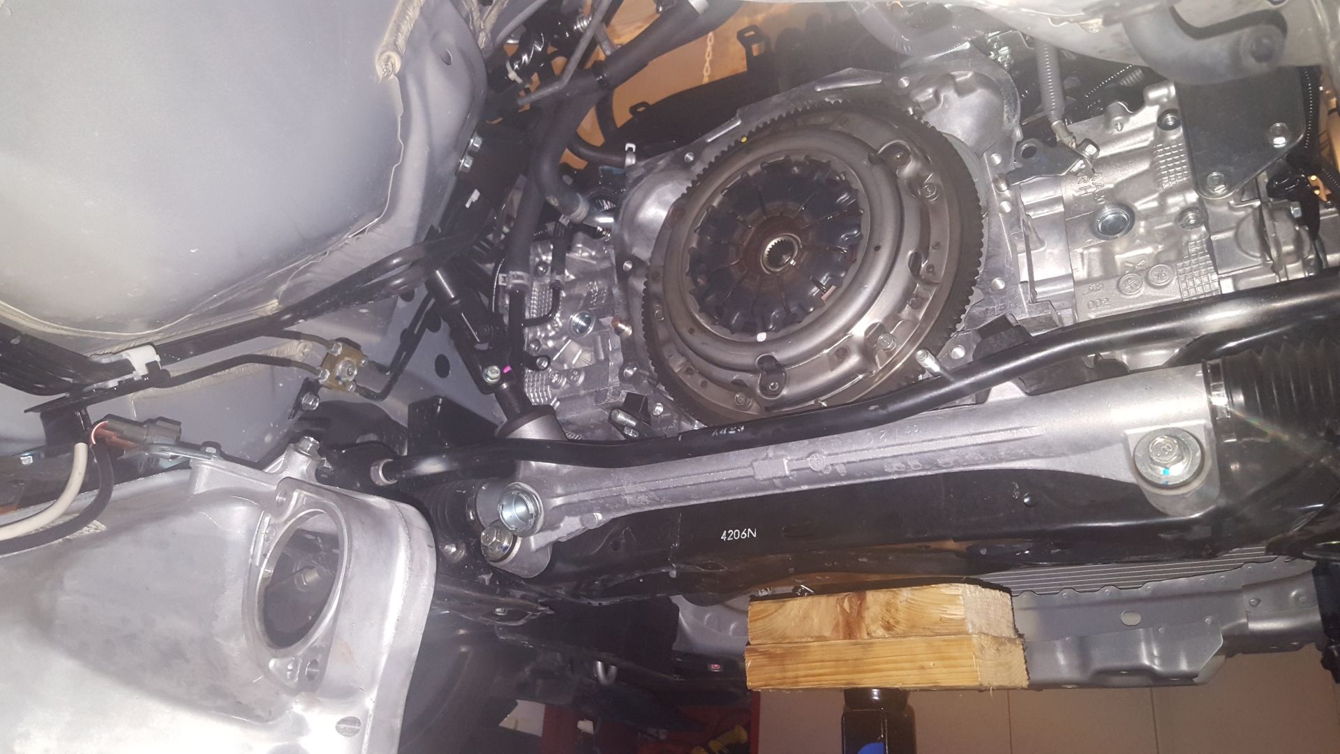

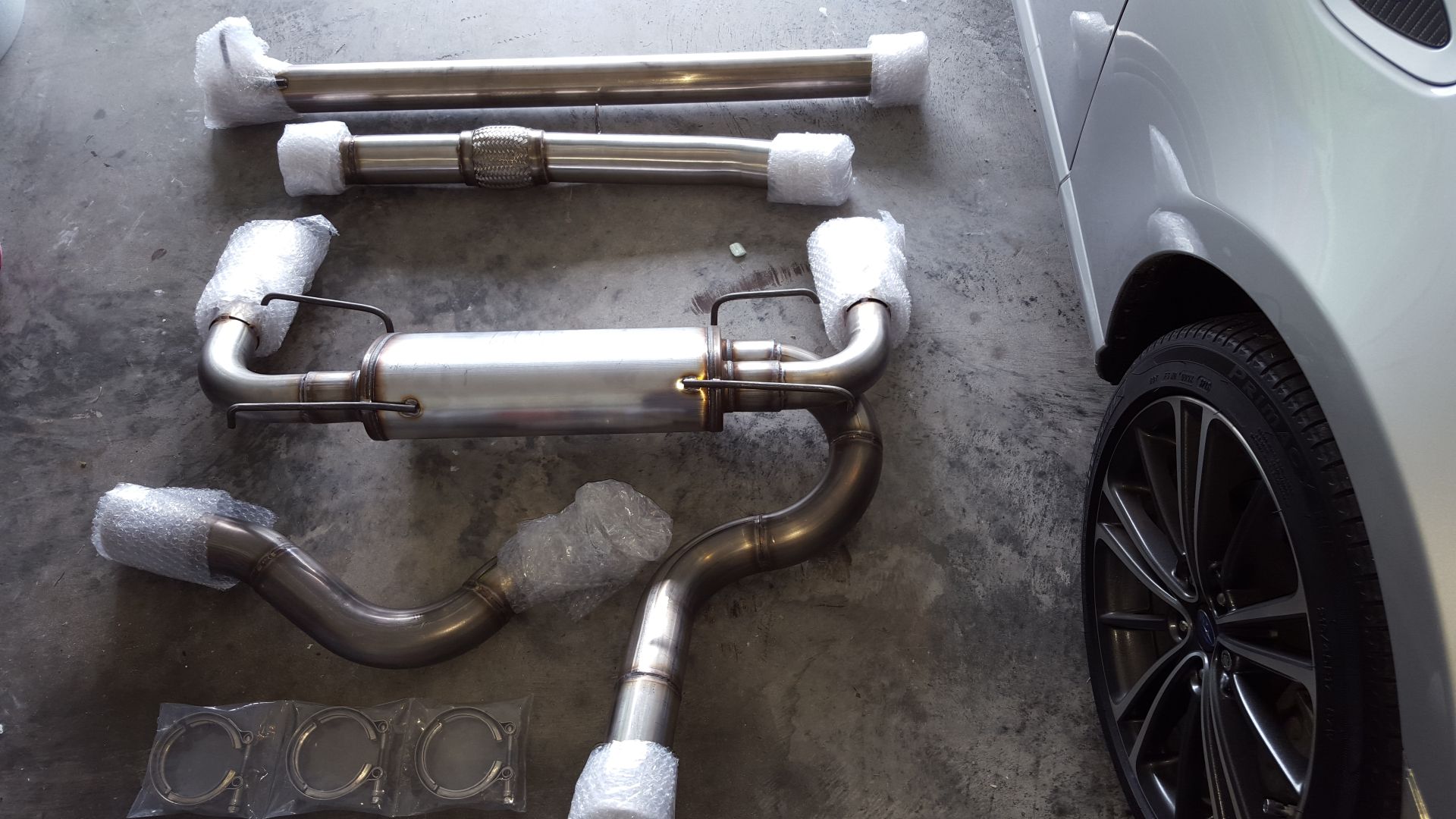

The exhaust was quick and easy. The clutch wasn't to bad thanks to King Tut's tip on jacking up oil pan to reinstall trans. I was able to lay the transmission on my chest and lift the little shit up and shake her into place without a jack. The V-band exhaust clamps aren't final nor tight. I'll tighten the clamps once the turbo kit is installed.

I just received my FBM 3" Exhaust including the 3" overpipe today from fedex! The FullBlown craftsmanship looks great. Either tonight or tomorrow I'll be removing my entire exhaust and dropping the trans to install my ACT clutch and Fullblown exhaust to break everything in before the FBM Turbo kit arrives in the next week or so.
I'm really can't express how happy I am to give Fullblown my money. I really hope they realize, the small things they do day to day means to us.
FBM 3" Exhaust

Factory toilet paper clutch is about to come off
ACT Clutch Installed
Trans kissing the floor

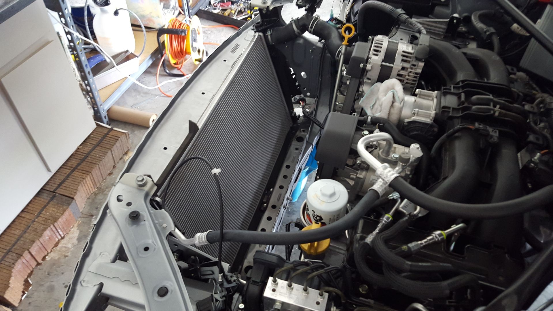

Naked Engine bay

You are welcome. This car is definitely one of the easier cars to do a clutch swap on, but it sure would be nice if it had a pitch stop mount like all the WRX/STIs with EJ motors do to stop that rotation of the motor. You should see how much stuff I had to disconnect and had to lower the subframe 3 inches to get access to bolts during the clutch install on my S2000.

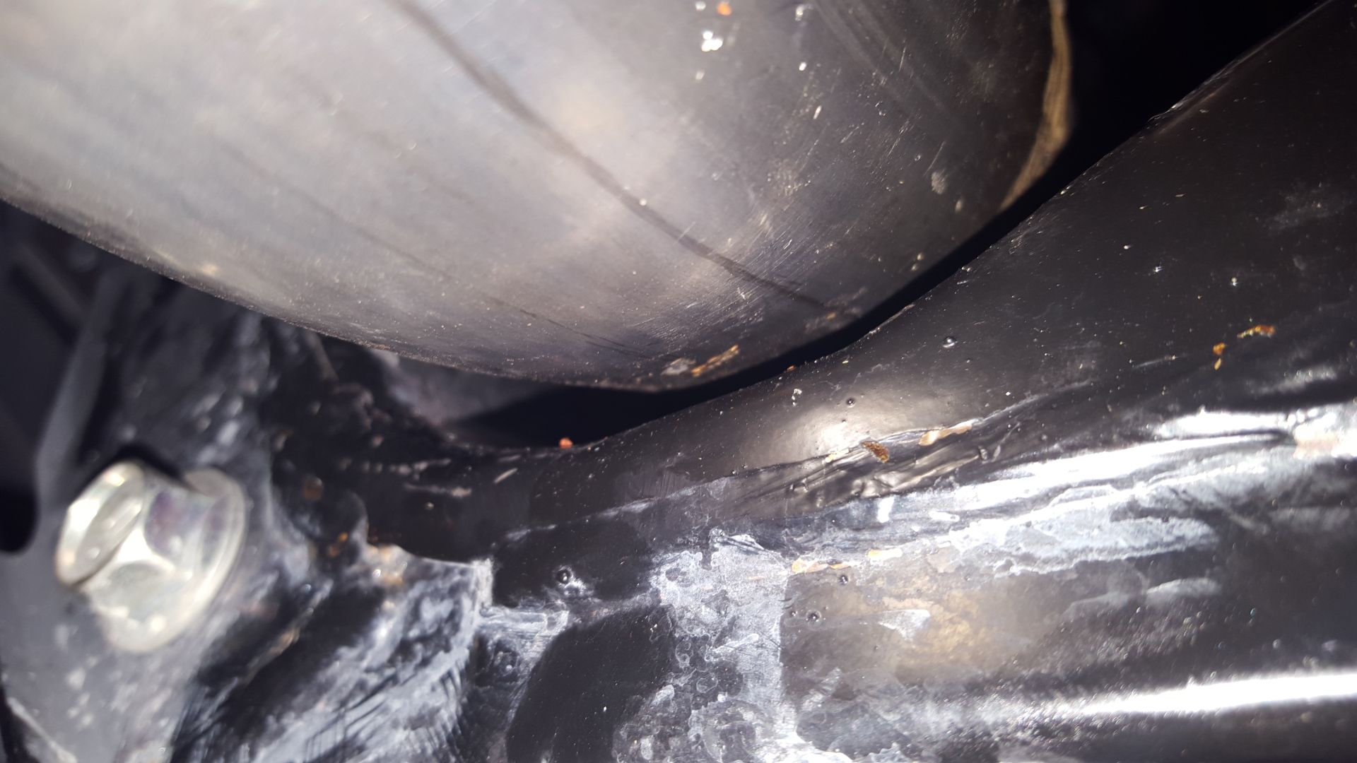

I know everyone talks about the customer service but damn. The craftsmanship and skill in these pipes is nasty awesome.
The pictures below is is the 3" exhaust mounted with 3" overpipe clearance with the downpipe connected. The clearance is perfect! about 2mm away from the motor on top and 2mm from the bottom. Nothing is hitting its damn perfect.
I still feel like an asshat with all the questions leading up to the kit but jesus these guys have it together with their craftsmanship big time. Also noted the pictures i'm finding on the internet of the kits piping for the intercooler and all doesn't get anywhere as nice as it is in person. FBM has really updated their shit. One less elbow on the intake side and the vacuum lines, water lines and fittings are much much nicer. The hose clamps are no comparison to the manual or other online photos. Everything is +2. I am completely shocked.
