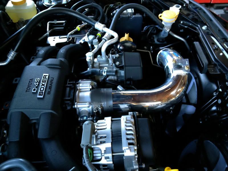

air intake undergoing research and development
this is just a teaser
more details and pics soon
MAF sensor works. no check engine lights!

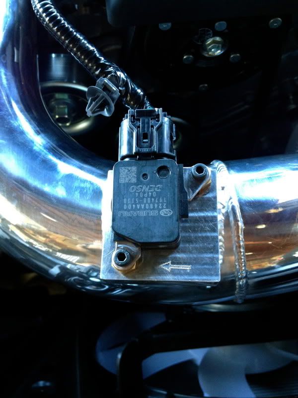

I dont like the bend coming right after the maf. It has the possibility to throw off the reading. A good clean straight section before and after is what i like to see.

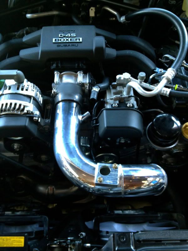

I'm guessing the filter will be right behind the big lower grille? If so that looks like a easy way to get water tossed right at it since the opening is large.
Agreed...place maf after that bend

After the MAF isn't as big of a deal as before. The air flow is going to be VERY different than stock. I'd want to see fuel trims in open loop.

So the MAF works but how accurate is it reading compared to stock?

we dont have data yet. we will gather data once the intake is ready
