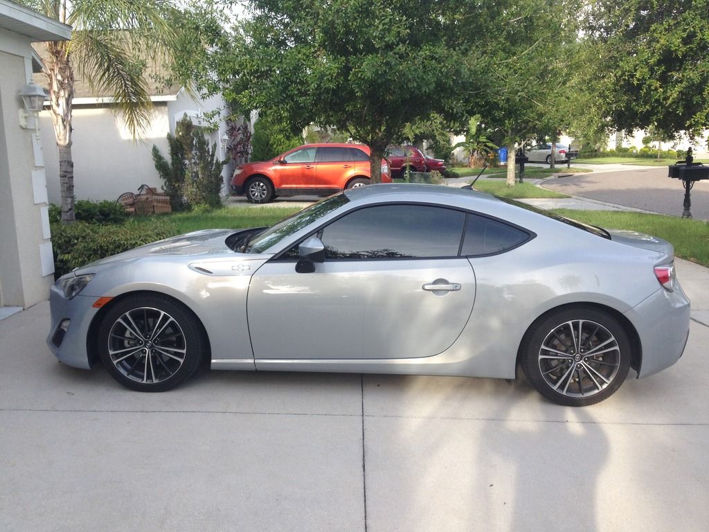

As you will see, below, my 10 Series is quite stock with the exception of the TRD lowering springs and window tint.

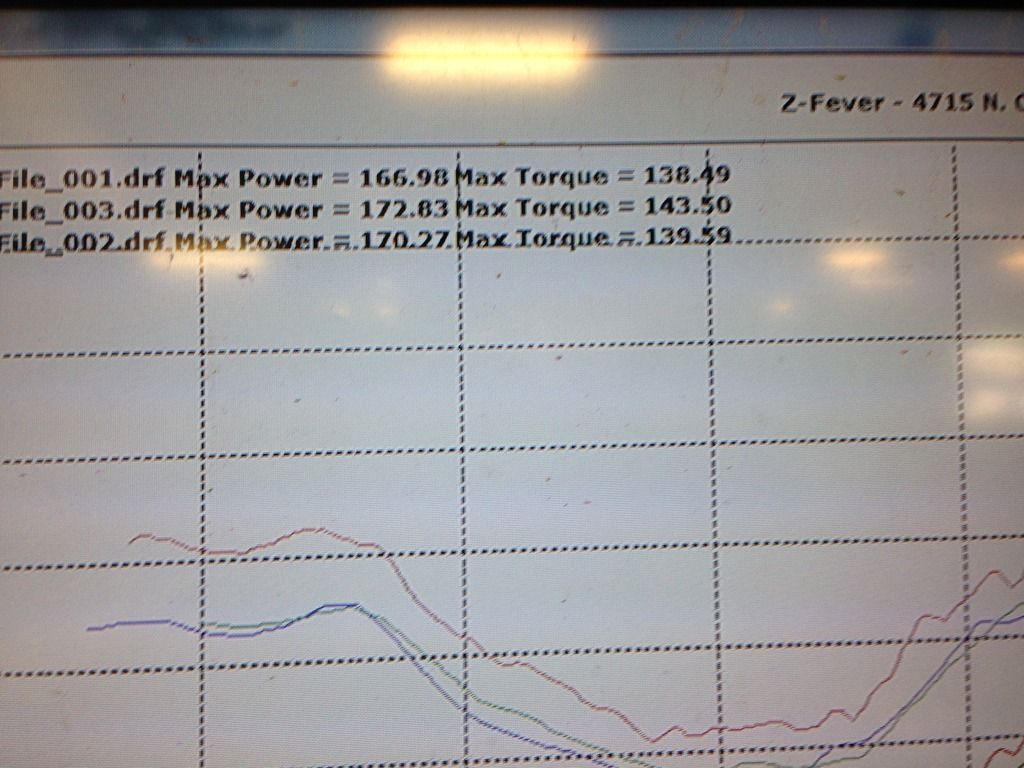

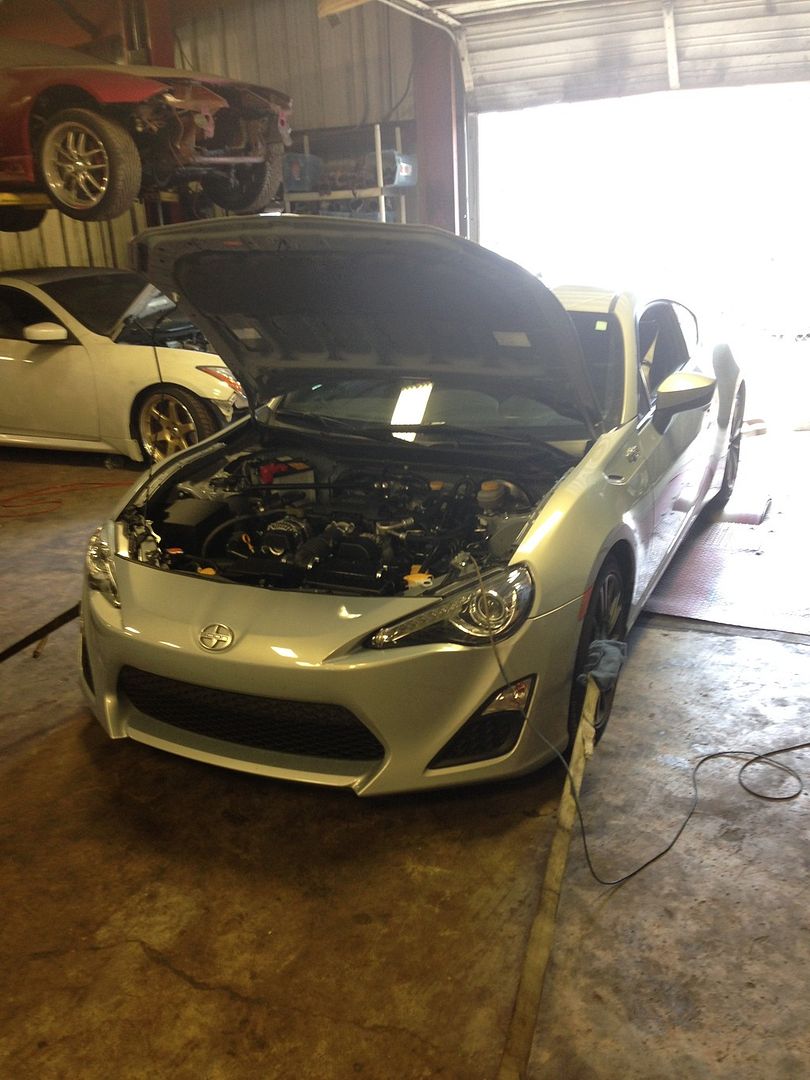

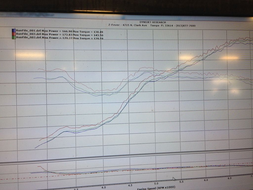

It began with getting the baseline dyno run, so I can measure the eventual gains.

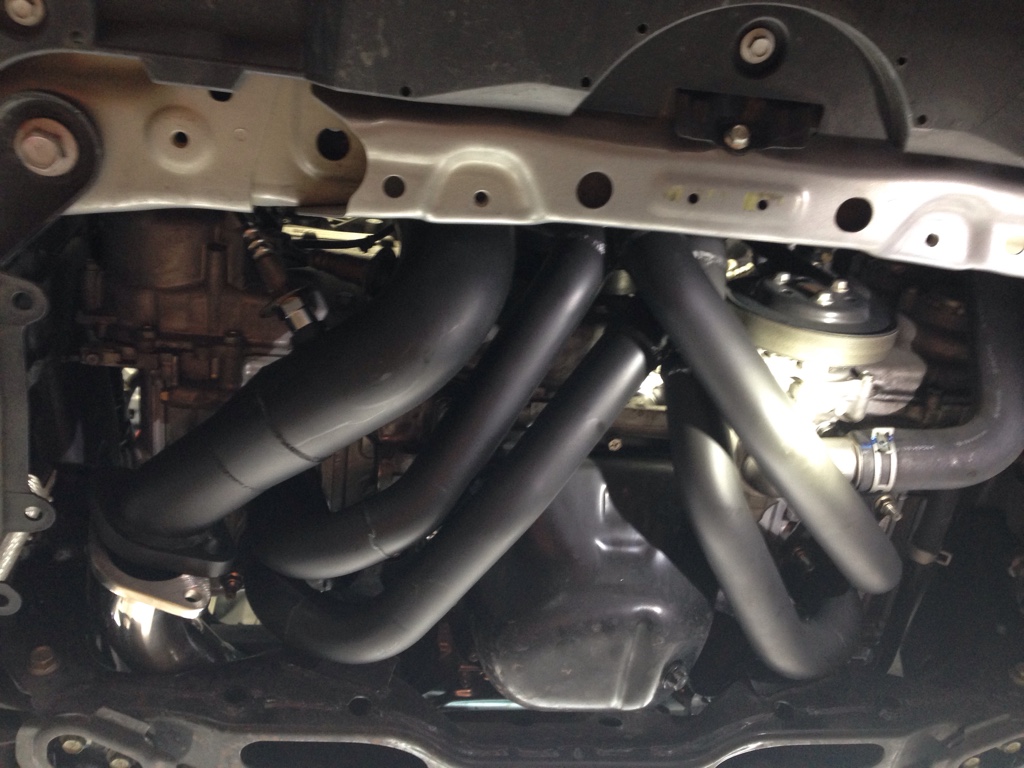

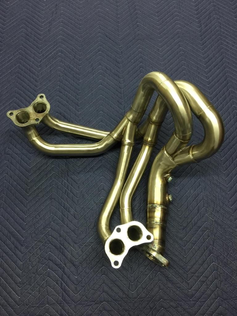

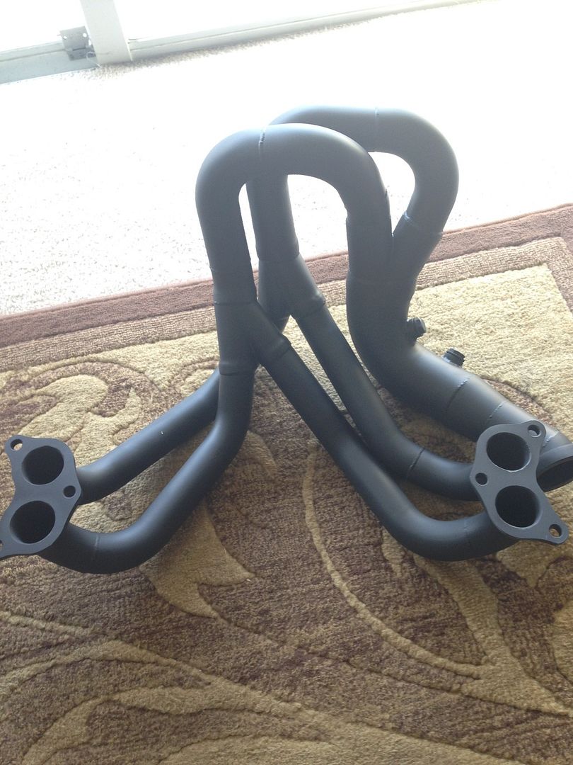

I used to own a GC8 Impreza and that turned me against the Subaru gargle forever. I happiest day of my ownership of that car was when I put the stock exhaust back on. LOL. So, I decided to start with an equal length exhaust manifold. Being that I am planning to remain NA, I also wanted a long tube option. Through my research I found several I liked and I ended up going with the PLM, which is basically a replica of the Nameless design. I do feel bad not supporting an American company, but at the end of the day, I'm more worried about paying my bills and not theirs. LOL.

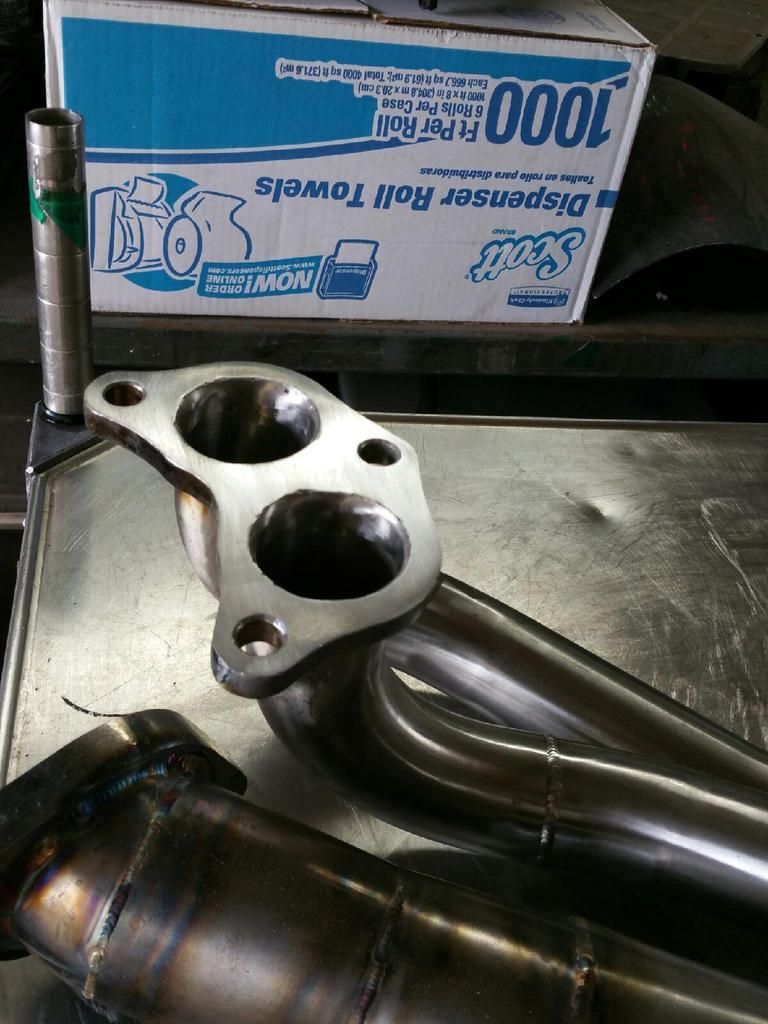

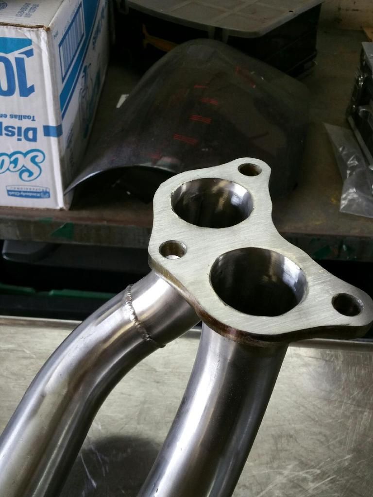

Everyone knows the problems with this header, so I decided to fix them. I necked it down to a 2.5 inch flange, filled in the internal welds by the flanges, ported them, planed the flanges and ceramic coated it.

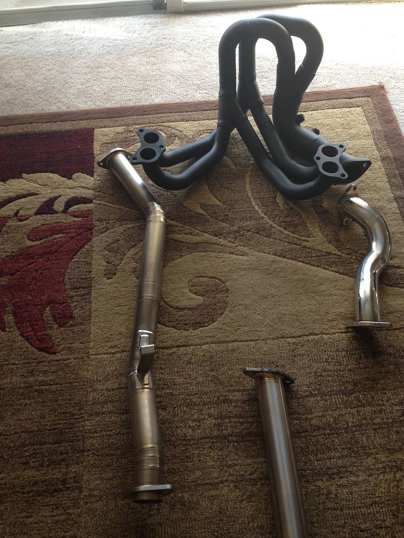

I have always had a thing for Titanium and I really wanted a full Titanium exhaust on my FRS. That proved a little more difficult than I first thought...

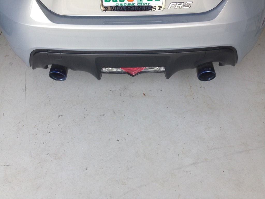

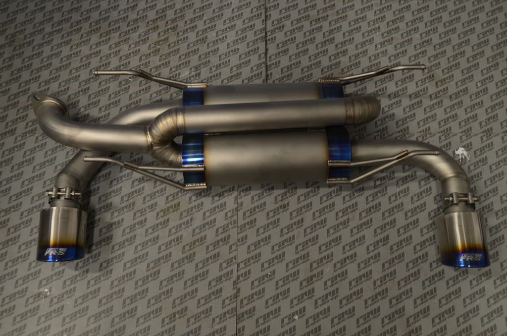

First, I found this beautiful axle back from a company in Florida that built it as a prototype and then decided not to manufacture it, so I got it for a steal.

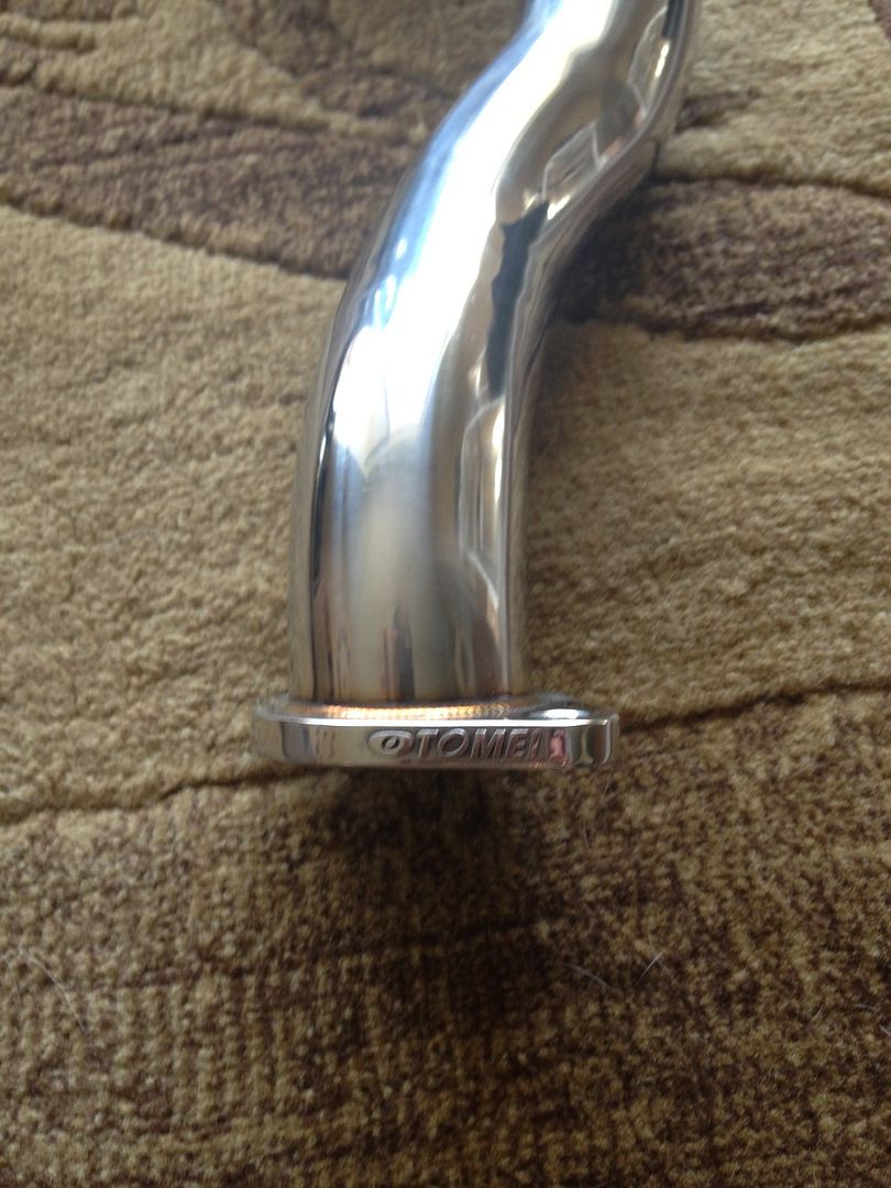

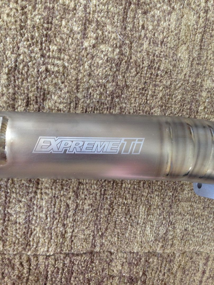

Next came the Tomei Expreme Titanium Straight Pipe and stainless steel Overpipe.

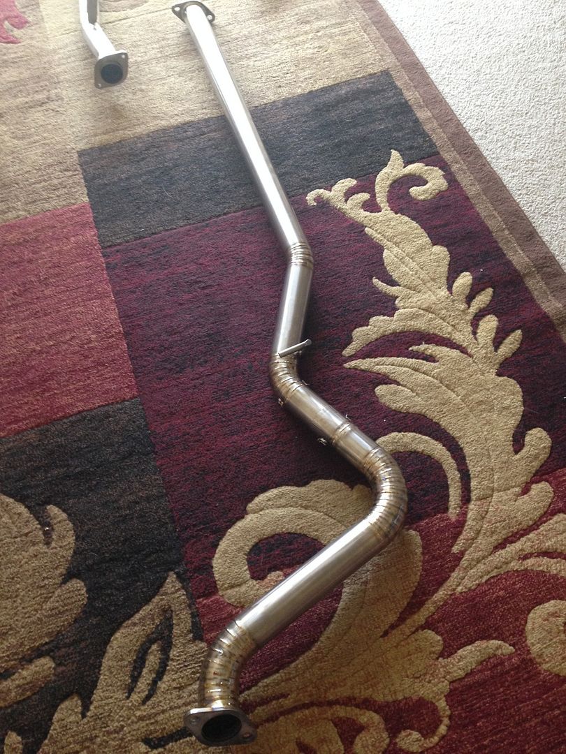

Then after much stress trying to find a titanium mid pipe, I decided to try to find someone to build one for me and that was just as difficult. Nobody wants to weld Titanium. Lol. Fortunately for me, as a member of this awesome forum, I posted on here in my time of need and JDL stepped forward and built me a beautiful custom titanium mid pipe.

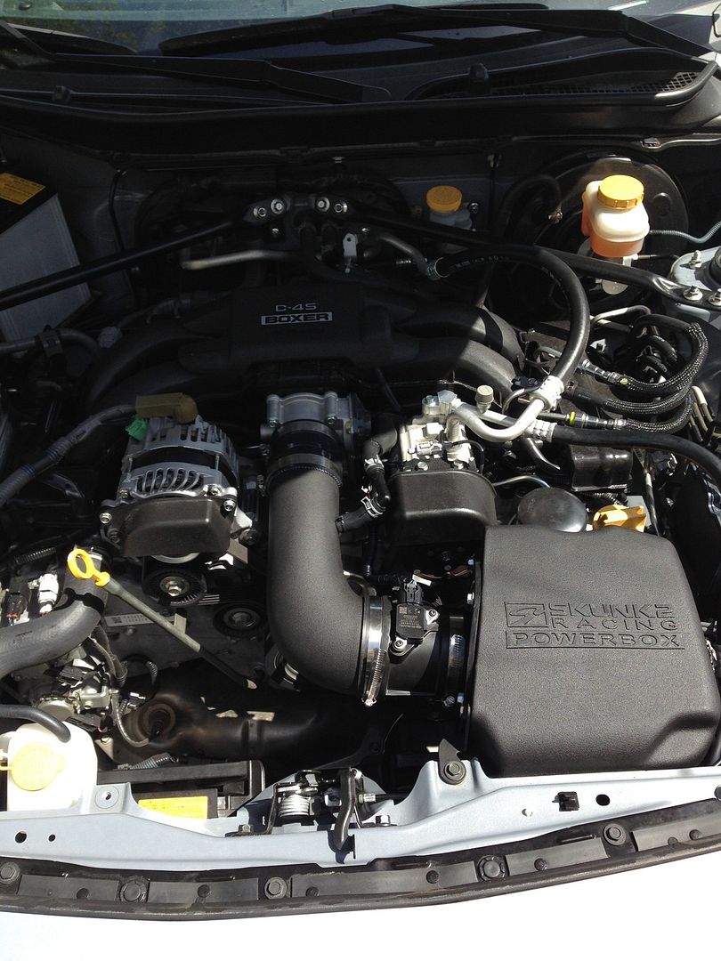

I already installed a Skunk2 Air intake which I really like.

DYNO VIDEO!!

interesting design on that axelback
nice start
