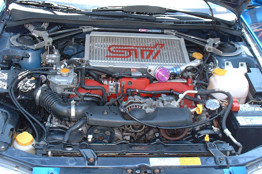

As for Celica's TMIC vs Subaru's TMIC is totally different. Here's both pic of Celica's TMIC and Subaru's TMIC
Celica
Impreza
Both pics aren't great pics (sorry), but you can see that Celica's TMIC is on top of the engine. While Impreza is behind the engine, that makes it not getting direct heat from the engine.

Good point Ichi. The Celica's IC is right beside the turbo and manifold, whereas on the Impreza the turbo is further away and the exhaust manifold is mostly underneath the motor.

Anyway, good point on the Intercooler placement, but one important thing, the Celica's intercooler is an Air-water unit, not and air-air unit like the impreza. Of note however, and admittedly I just found this info, I did not know this;
The biggest drawback of the Impreza boxer engine is the proximity of the inlet manifold to most heat sources in the engine bay. Additionally the intercooler is located above the engine, which is definitely not the best place to put it, hence the big central air vent on the bonnet. A similar choice, for the intercooler placement, in the Nissan Sunny GTi-R of old resulted in engineers calling it inter-warmer...Locating the intercooler this way results in relatively high intake air temperatures of around 50 °C and thus reduces the engine's efficiency. The racing version of the Impreza uses an intercooler which is relocated in the front bumper.
