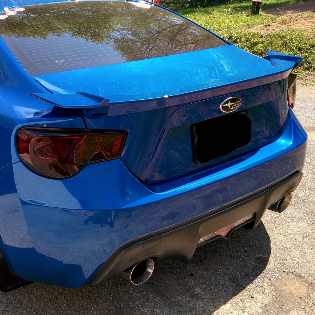

as toast above me said. YOu are really going to want to clear them. VHT Nightshade on its own will not hold up to the elements well.
I did this on my old FRS, need to do it to my 10 series. I honestly much prefer the look of a nice deep red stock tail to just about every other aftermarket tail light. I did not think I would until I did it and saw it in person.

Very nice writeup! Its amazing what a wetsand and polish will do.
I agree with the guys above, you really need to clear coat them if you want them to stay nice. I clear coated mine, let them sit to dry for a day and then wet sand and polished them. I've gotten many compliments on them.
