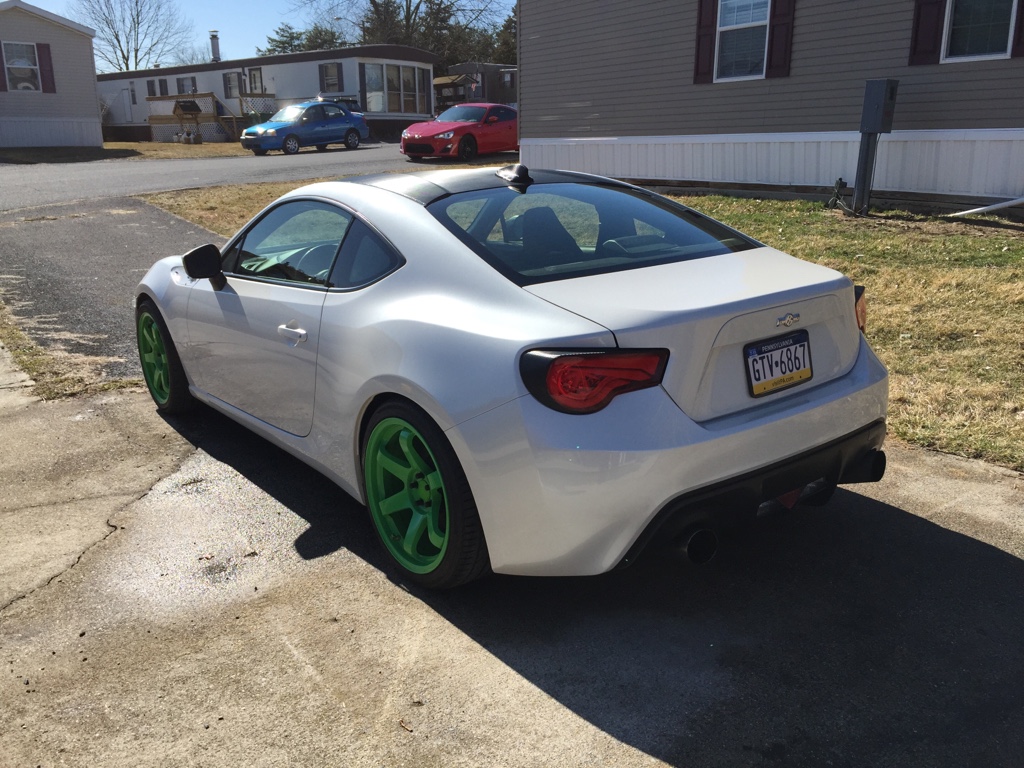

Eliminate all the concerns above^ as well as save yourself the hassle of getting the same tires in 2 different widths but trying to maintain the same overall diameter, just run 255 on all 4. 255 is perfect on an 8.5 and barely has a stretch on a 9.5. You keep all the benefits of the square setup, while gaining the benefit of the staggered fitment (front cant be 9.5 w springs w out either hitting the suspension or poking out of the fender 3/4"). I have the exact wheel specs as OP
Attachment 110520
Running a 255/35 on front and back? Do the front and back end up being a different height?
2013 BRZ Sport tech, Saskatchewan
I think you mean 225's? A 255 will be pretty squished on an 8.5, and definitely not stretched on a 9.5.
What tires are you running? Different tires also run at different widths, despite being marked as a given width. My 205 snows are wider than the stock 215 Primacies.

255 fifty five. Ventus evo2s. They are flush on the 8.5 and slight stretch on the 9.5
