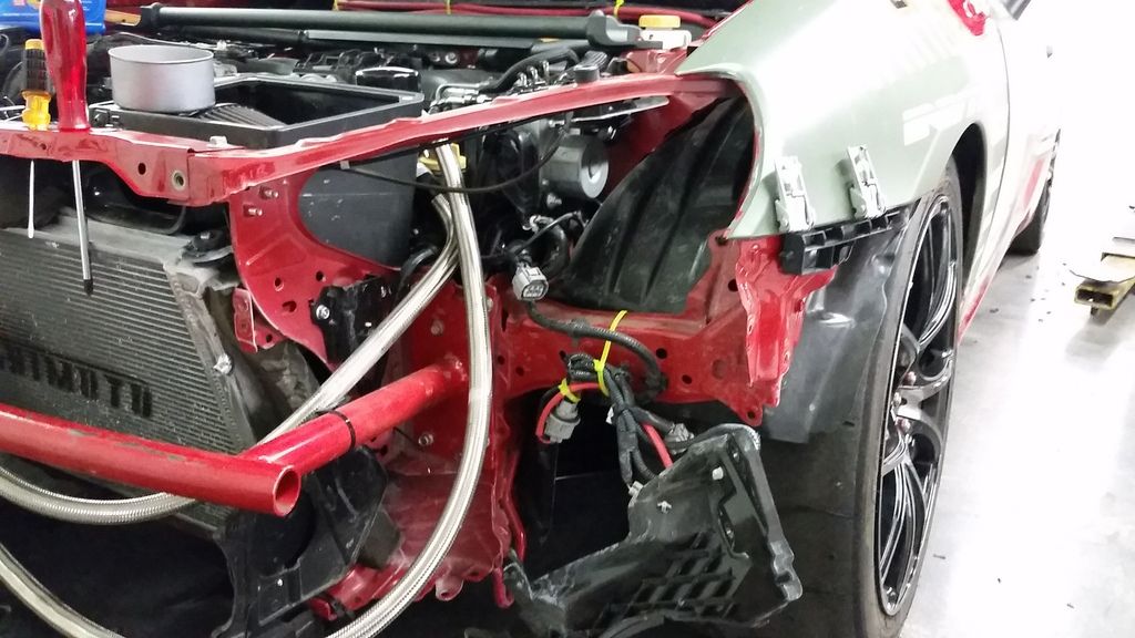

First we removed our bumper and headlights.

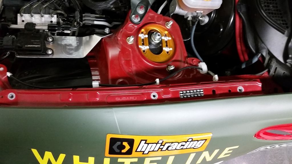

Next, we removed all of the bolts holding the fender on (this photo shows 3 of them)

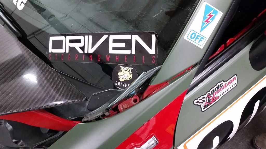

You must also pop off the cowl to get to a another fastener:
Here is a shot of the entire OEM fender, headlight, and bumper removed from the race car:

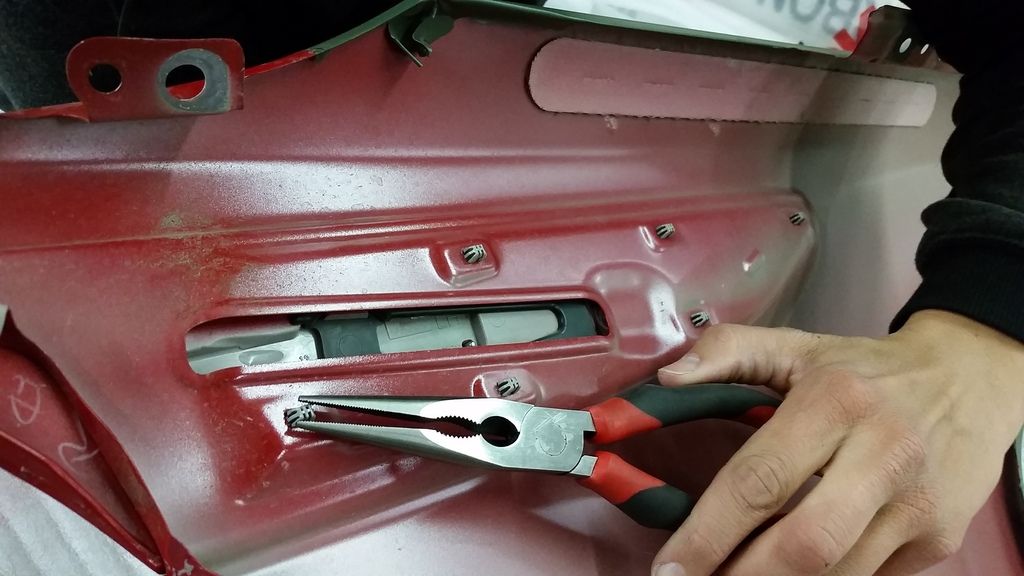

To remove the fender garnish we used a needle nose to squeeze these clips and release it:

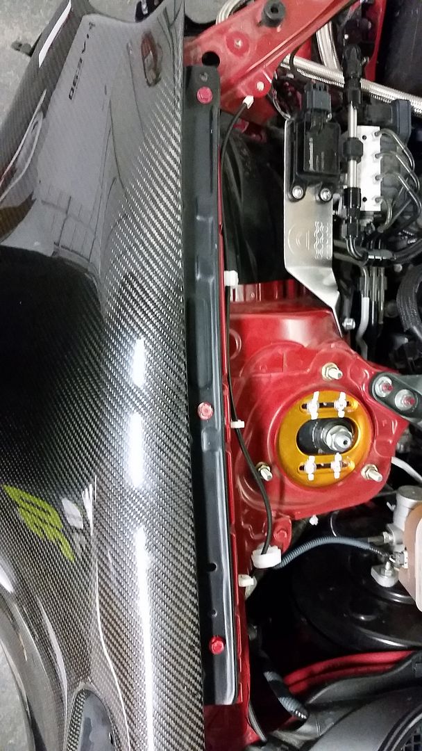

Then we transfered the fender guides from the OEM fender to the new Seibon Carbon Fiber Fenders:
Lastly, we aligned the new Seibon Carbon Fiber fender and bolted it on in all the same oem locations with the oem hardware:
We completed the same steps on the other side of the car, and that was it! Everything aligns perfect with the fitment of these fenders. We saved approximately 6 lbs with these new fenders! Be sure to check out the reveal video that highlights all our new upgrades and changes for the 2015 season:
