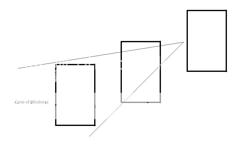

I never really understood people talking about blind spots or having to look over their shoulder to change lanes. Like the post above states, if you have your SIDE view mirrors angled correctly, your peripheral vision/rear view mirror/side view mirror combine to eliminate blind spots.
Wrong. There is cone of blindness that starts just behind the driver's seat on the driver's side and expands outward the further an object is from the car. Here is a crude line drawing to illustrate:
If you have your mirrors adjusted correctly, you will be able to see a car in the lane immediately next to you because that cone of blindness is narrower than a car in that lane. But since the cone expands outward, if a car is another lane over (for example in the far left lane of a three-lane highway), it is impossible to see in the mirrors because the cone of blindness is wide enough at that point for the car to hide in.
I drive a lot on interstates (just over 30K miles on this car in my first year of ownership), so I've had plenty of opportunities to observe this phenomenon in the real world. If I am driving in the right lane on a three-lane interstate and want to take the center lane, I have to physically look over my shoulder to ensure that someone from the far left lane is not also attempting to take that lane. This can present a real challenge in heavier multi-lane traffic in cities. It's also a challenge in areas that have entrance ramps from the left. The cities I travel in and to for my job have a lot of both.
I have tried a number of adjustments to the mirrors to eliminate that blind spot. It isn't possible, at least not with the stock mirrors.
Edited to add another, more detailed crappy drawring:
