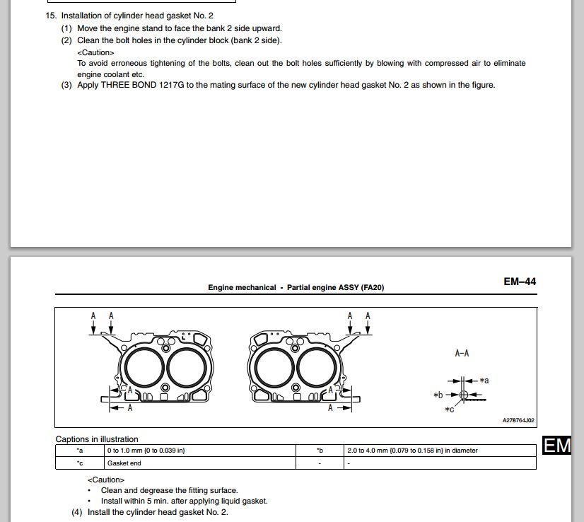

I am just about ready to install new head gaskets.
According to the service manual I have to apply gasket sealant.
Am I doing this correct if I apply gasket sealant around were I have marked with red? Missing some spots? Any areas that should not have gasket sealant?
I am really hoping not having to do this twice...
