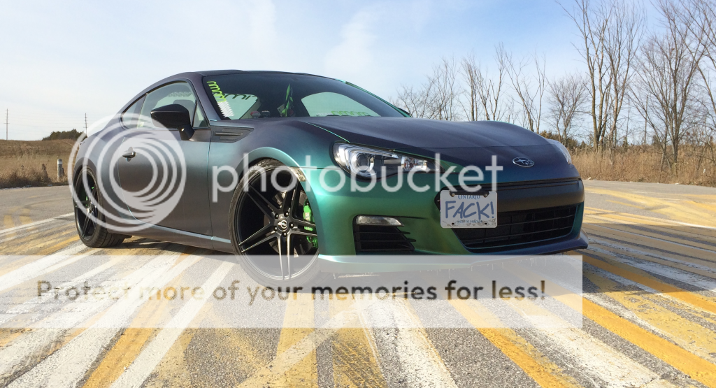

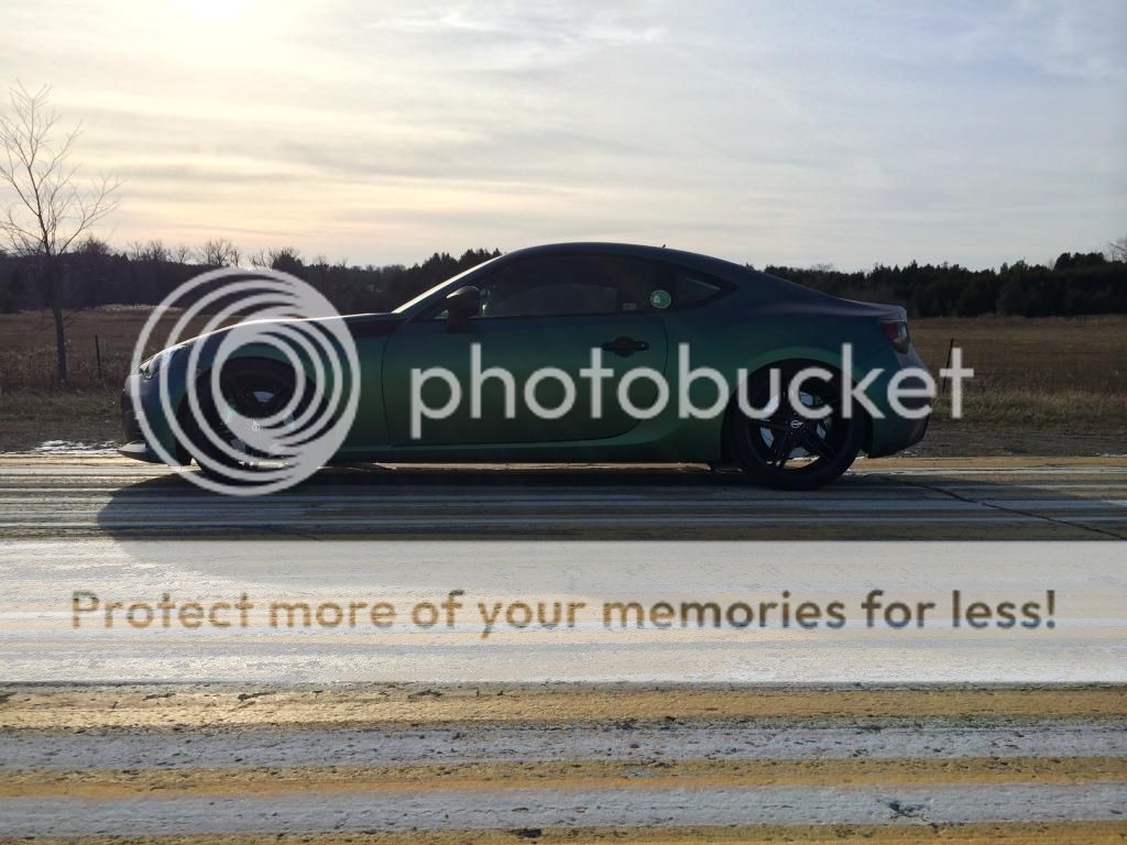

Hey my whole car is wrapped Chameleon green and Brushed Black, I'd be glad to try and answer any questions you might have!

Thanks. Do you have a bigger picture of your car? It looks great.

It's coming along, still not where i want it to be at yet. Isn't that the case with everyone though? lol Anyways, I posted some below. Wish I had my buddies DSLR that day, only had my Iphone
